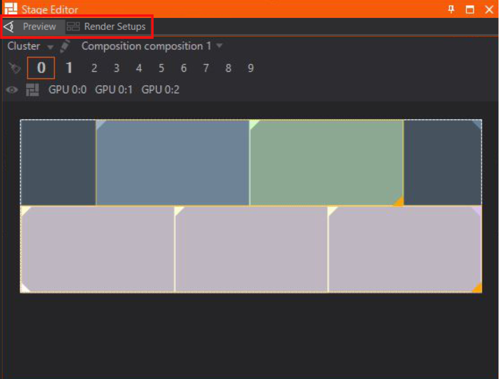

The Stage Editor enables previewing of different Screens, Previs Screens and Compositions as well as outputs and other machines inside a Cluster. Furthermore you are able to switch, edit and create Render Setups quickly.
The Stage Editor has two tabs: The Preview view, with selections of different Screens and Compositions and the Render Setups view to create and manage the Render Setups.

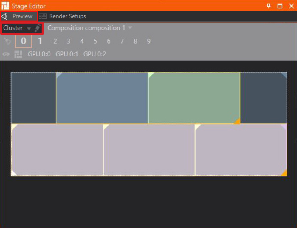

Render Setup Selection and Editing
Also in the Preview view it is possible to quickly select your Render Setups from the drop down menu. Use the to get inside the Render Setup Editor and edit the currently selected Render Setup.
A restart of the Designer is not needed. Hit Save after changing the Render Setup and the changes will be instantly applied; Alternatively, click Live at the top of the Editor to see your changes update in real time!

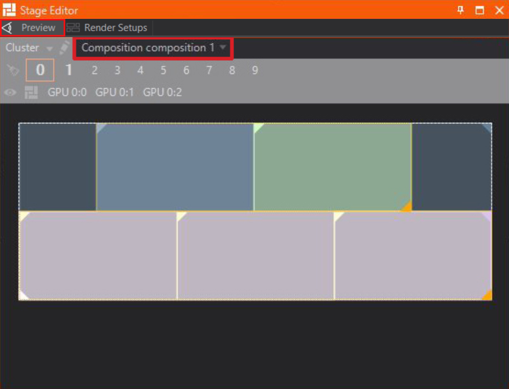

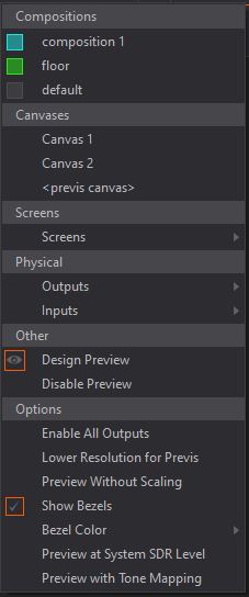

Preview Selection Menu
With the Preview Selection Menu it is possible to switch between different Compositions, Previs Screens, Screens and Canvases which are defined inside the Render Setup. These will be then previewed inside the Renderer Window.
When working with a previs scene the Composition preview may show content with a strange aspect ratio; this is not a bug but rather a technical limitation. This is due to the Render Order, at the point of previewing the Composition the engine doesn't know the design size set by the canvas. It will fall back to the Aspect Ratio set in the Project Properties window.
Physical
This previews the physical device output. Depending on the setting Enable All Outputs, it behaves differently.
Enable All Outputs Behavior
On Previews the output of the device as configured in the Device Configuration.
Off Previews DUMMY Outputs as configured in the Render Setup output mapping tab.
Inputs can be previewed if configured inside your Device Configuration.
Design Preview
The Design Preview will show all configured Previs Screens, Screens, Compositions, Canvases and other machines defined in the Render Setup combined as one preview. This should give you a good estimate of what your scene will look like.
Using the Design Preview in conjunction with the option to Preview Without Scaling can have a heavy performance impact on bigger scenes with high resolution!

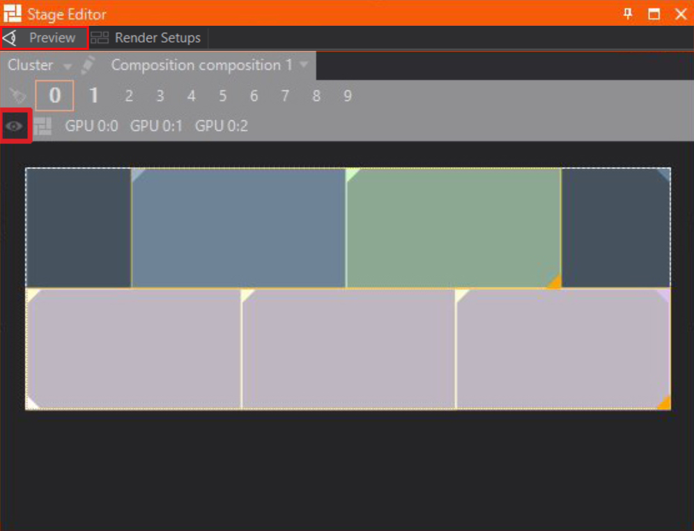

Disable Preview
Disables the preview Renderer window.
This doesn't completely block Ventuz from rendering your scene. See it more like the "inactive" flag on a node. To completely disable the rendering use the option inside the Device Configuration for Disabling the Preview Window.
Options
Enable All Outputs: Will use all physical screens currently configured as outputs inside your Device Configuration and render your scene on it, except the screen with Designer open. When disabled, the Preview Renderer will render the Physical Outputs as configured in the active Render Setup, instead of the Device Configuration.
Lower Resolution for Previs: This will divide the Resolution inside a Previs by 4. Some Previs scenes can have very large resolutions; to ensure good performance while working on it we introduced this option.
Preview without scaling: This forces the Renderer to render the current preview in its configured resolution coming from the Render Setup, it will also crop the image if the renderer window is to small.
Show Bezel: Use this to show currently configured bezels coming from the Render Setup inside the Rendering Window.
Bezel Color: Change the rendered bezel color as well as the transparency by using the alpha values below the color wheel.
Preview at System SDR Level: Whith HDR mode on: Sets the SDR white-level of the preview renderer to the Windows SDR level of the Windows Display Settings.
Preview with Tone Mapping: Whith HDR mode on: Performs a bt2390 rgb display transform to tone map linear HDR to SDR.

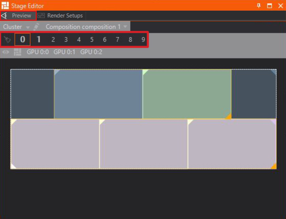

Machine ID Selection
Use the broom icon to display what is used with your current machine ID, which is configured on the general tab inside the configuration tab inside the Configuration editor. Or Preview other machines outputs from your network with the corresponding ID.
Changing the previewed machine ID will only render on Enabled Physical Outputs; make sure to enable this option inside the Preview Selection Menu!

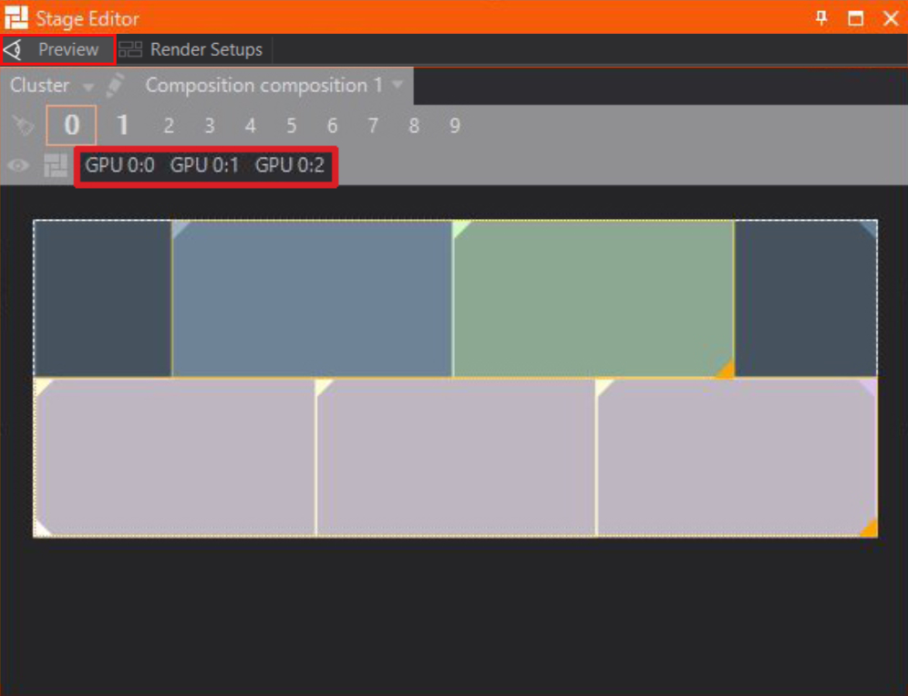

Connector Selection
Preview single outputs which are currently configured in the Device Configuration.

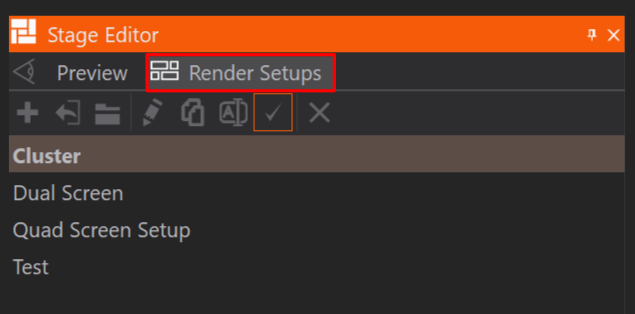

Render Setups view
To create, edit and mange the Render Setups switch to the Render Setups view of the Stage Editor.

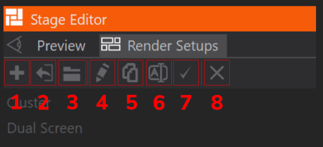

The active Render Setup is highlighted in orange and when selected the tick is selected. To activate a different one, select it and activate the tick (7). To edit a Render Setup, double click 2x  the name of a Render Setup or press the pencil icon (4). To add a new one, the plus icon (1). Rename a selected Render Setup with a on the name or with button (6). Button (2) imports a Render Setup from a file from disk. Button (3) opens the Render Setups directory. Button (5) duplicates a selected Render Setup. And button (8) deletes the selected one.
