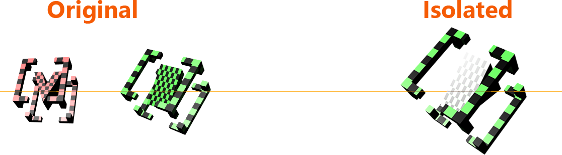

The isolate Mode is basically the Render Point functionality. Doubleclick  doubleclick any object in the Render Window. This will set a Render Point for the selected Object, all other parts of the scene tree are ignored. The navigation and shortcuts are listed below. Doubleclick  doubleclick the selected object again to leave the Isolate Mode

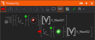

Selecting a node and pressing CTRL + R will set the Render Point to that Node. Additionally you can activate the Render Point in the Hierarchy/- Toolbar or select the Set Render Point from the context menu with a  click on the selected Node. The Render Point defines teh isolated subtree in the Hierarchy. For the following screenshot it means the V_Mesh02 is isolated and centered in your Rendering Window.
As you can see in the screenshot above, other meshes are skipped but Materials, Transformations, Lights are still applied to your isolated mesh or subtree.
In contrast to Ventuz 4 or earlier versions the render engine is not starting to traverse the scene tree at the selected node. The whole tree is traversed but meshes outside the isolated subtree are skipped.

To isolate a Layer from its composition select it and press CTRL + R. You can also press the Isolate button on the Layer Tool Bar. It allows you to view and edit the Layer outside the context of your already finished composition without changing the actual surrounded logic.
It becomes a mandatory tool when you start working with OffScreen Layers that are already applied somewhere else but you need to check the actual outputted Texture without destroying your surrounding logic.
