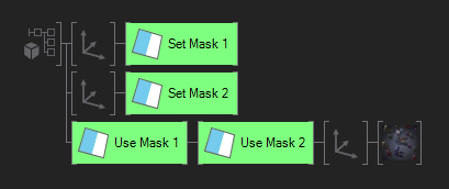

Use 3D Mask
After a Mask is created, it can be used anywhere inside the same 3D Layer. Based on the Index, all elements behind the Use 3D Mask Node will be masked by the respective mask.
To use multiple masks on the same elements, Use 3D Mask Nodes with different Indices can be cascaded.
