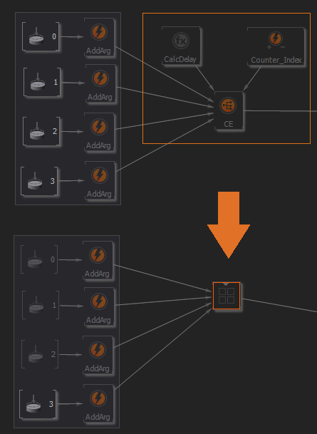

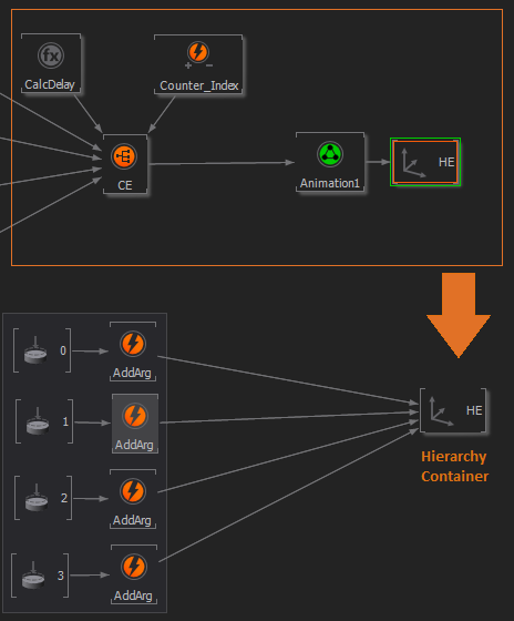

An alternative way is to select a node and then use Node/Merge To Container from the main menu bar. This will replace the selected subtree with a container and place the removed nodes inside the container.
Next to merging a selection to a Hierarchy Container it is also possible to merge content nodes to Content Container.
There are basically four different ways of merging:
  • Selection in Hierarchy Editor
    1. A single Hierarchy Node is selected with children.

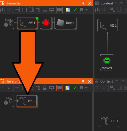

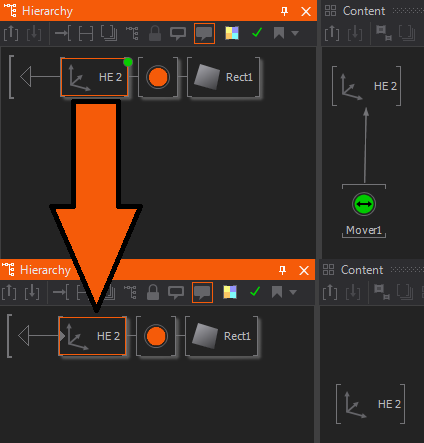

      If all selected nodes (including value suppliers) are only connected to this partial tree - the merge is performed and a new Hierarchy Container is created
  1. A single HE node is selected without children click +CTRL.
    Only the single HE node is merged with all its suppliers - a new Hierarchy Container is inserted at the previous location. The icon of the previously selected HE node is exposed. Outputs and multi-links are maintained.
  • Selection in Content Editor
    1. Only CE nodes are selected.
      All nodes are merged into a new Content Container. Bindings that pointed outside the selection are re-created by new exposings.
  1. A single HE node is selected and optional one or multiple CE nodes.
    Basically the same as Selection in Hierarchy Editor (2) (above) but only the selected CE nodes are merged. Bindings that pointed outside the selection are re-created by new exposes and the icon of the previously selected HE node is exposed.

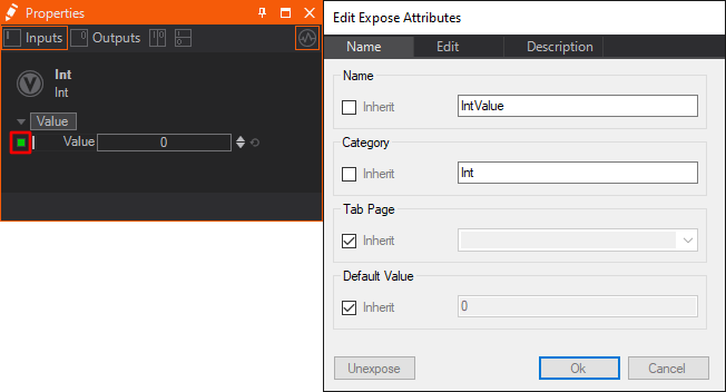

Any input or output property of a node inside a Layer or Container can be made available on the outside as a property of the Container itself by exposing it.

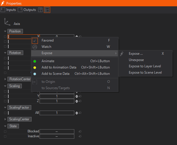

To expose a property, click  on the name of the property in the Property Editor and choose Expose/Edit... from the appearing context menu. The name and category of the property, as it appears on the Layer or Container, can either be kept the same as on the original node or be reassigned in the dialog that opens. Press OK and the square to the left of the property name will change to green, symbolizing that this is now an exposed property. Note that exposed property names have to be unique within a container. Exposing two properties with the same name will not only confuse other Ventuz operators but can also disrupt the binding logic.

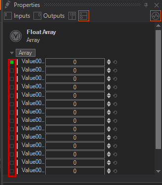

To quickly expose a property without changing its name or category, click  the small square to the left of the property. To quickly "un-expose" a property, click  on the square. A double-click will bring up the Expose dialog.
Since Ventuz 5 we introduced a new level in the Scene with Layers. To make exposing a little more handy properties can be exposed to Layer Level or Scene Level directly from the context menu. Pressing the on a category also allows exposing all properties inside that category to a certain level in the scene or to Scene Data to control them from Ventuz Director.

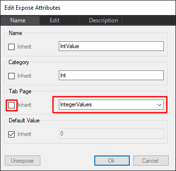

With Ventuz 6.6 we introduced Property Tabs. These allow to sort your properties into custom tabs. To do this simply doubleclick  the expose button and a new window will pop up.
If inheriting is enabled the exposing will appear on the same tab like the exposed property. To change that uncheck the according checkbox. When changing the name you can also use the dropdown to choose from a list of already present property tabs of the current container.
After typing in the name of the tab you can hit OK, and now you can find the new tab on the top of the Properties Editor at the according container.

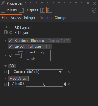

If you want to add multiple exposed parameters to one tab, you need to expose the needed properties on the node itself first. Then jump up one level and mark all of them with shift + Left click .
Right click  one of the selected items and add them to an existing tab, create a new one or even remove it from the current tab.
This only works on selections on the container/layer - not on the exposing node itself.
The selected tab will always be highlighted in Orange.
Data items with no allocated tab, will be always displayed. Regardless of the tab selected.

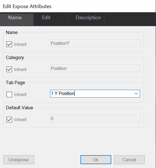

It is also possible to sort these Property Tabs by hidden numbers instead of the Alphabet. To do this you only need to name your Tabs by starting with a number. This number will not be displayed.
This number will keep the Property Tab up front. Even if we add another tab that is starting with an A for example.

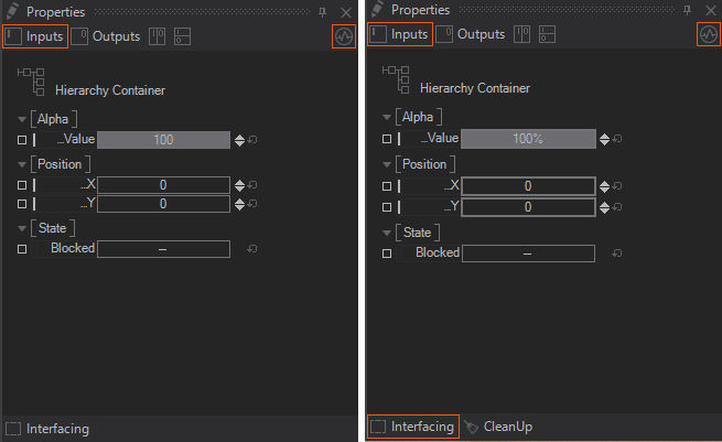

To define an interface, a Container with exposed properties is required. When selecting the Container, an "Interface" button appears at the bottom of the Property Editor. Press it and the container is upgraded to an Interface Container, which is visualized by two lines that close the gap in the brackets that surround the node icon.
When changing a Container to an Interface Container, all exposed properties become interface properties. The difference between them is that interface properties remain defined on the interface even when the property is no longer exposed. All properties exposed after that automatically become interface properties as well.
When removing a node that exposes a property, the interface property stays intact but is visualized in a light gray color. To remove an interface property definition, either double  click on the interface property and press Exclude or use the CleanUp button at the bottom of the Property Editor to remove all interface properties without an corresponding exposing node.
Interface properties can be recognized by the thicker stroke around the green "exposing square" (when the exposing node is selected) or the thicker stroke around the property (when the container itself is selected). One has to be careful not to confuse what level of exposing one is currently looking at.

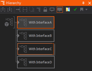

When using drag & drop with an Interface Container, all containers in the scene with an interface defined are highlighted with a dark gray border. When dragging  the selected container over such an interface container, the target's border changes to red. Releasing  in this state will not remove the original node but replace the targets content with that of the source node. The same behavior is achieved by using Edit/Copy and Edit/Paste Container Content from the main menu.
In addition, Ventuz will try to reconnect as many interface properties as possible via its Interface Matching Algorithm. Exposed and Interface Properties match each other if they fulfill the following requirements:
