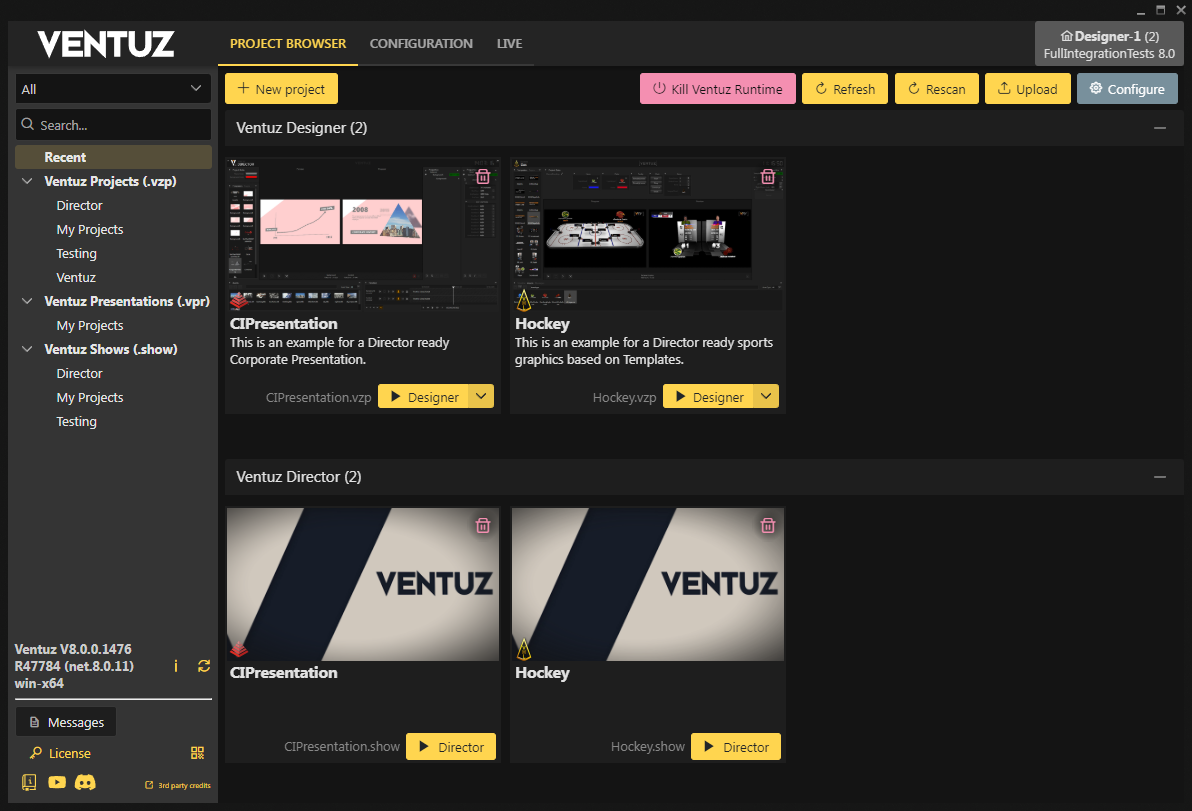

Project Browser
The Project Browser shows the used Designer Projects (.vzp), Director Shows (.show) and Runtime Presentations (.vpr). On the left side you can either see the recently used files or browse projects, shows, presentations based on their categories. Every displayed file type allows to be started with the associated application. This can be done clicking the button in the lower right corner of the displayed tiles. Presentations (.vpr) can only be started with the Ventuz Runtime, Director Shows (.show) can only be started with the Ventuz Director whereas Designer Projects (.vzp) can started with the Ventuz Designer or Director because Director Shows are always initially created based on Designer Projects. Clicking on a tile in the browser gives provides you further information for the associated file.
On top of the browser page you will find a row of buttons to perform certain actions:
New project Provides a dialog to configure and create a new Designer Project
Kill Ventuz Runtime Allows to stop running Designer and Runtime (this button is only visible if either Designer or Runtime is running)
Refresh Reloads the browser content. This can also be achieved by pressing F5 key.
Rescan Starts s project scan in the configured VMS search paths and updates the browser content if new projects have been found.
Upload Allows to upload VPR files to a remote machine where Ventuz is installed.
Configuration Configure the project search paths for the VMS project scanner.

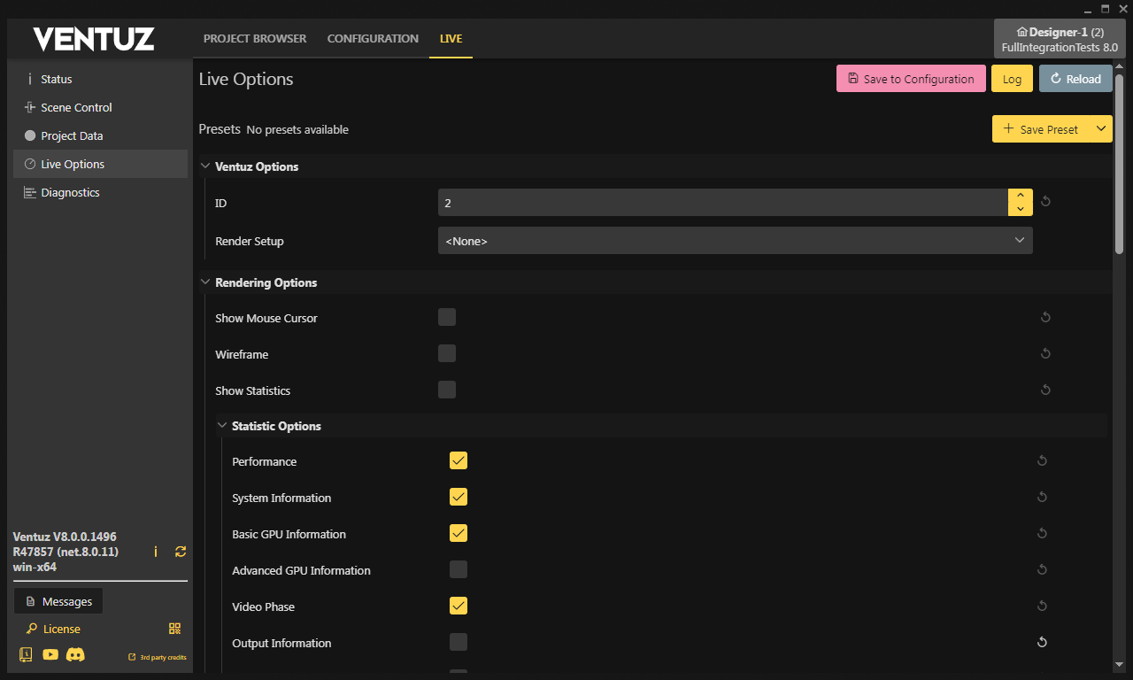

Live Options: This section allows to enable and modify certain parameters that can be changed during Ventuz Runtime is running without the need of changing the Machine Configuration or Device Configuration. These are e.g. the Statistics or some Rendering options. For a full description to Live Options.

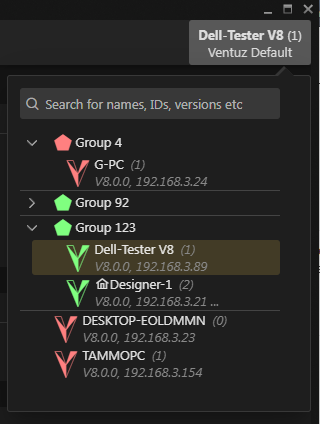

Machine Selection
The Machine Selector shows all machines discovered within the network. All these machines can be configured from your local or web Configuration Editor. The Ventuz Machine Service broadcasts its VMS signature periodically. The Machine Selector receives these messages and add the entries to the selector. Machines without VMS running can't be discovered and configured!
The entry with the House Icon on the left marks the local machine. The local machine is the default selection when the Ventuz Configuration Editor is started.
The selector automatically groups all machines with the same GroupID. To select a group click on the group label (here Group 2).
With the Search Bar it is possible to search in the available machines via the name, the ID or the Ventuz version and list the machines accordingly.
Each entry has a colored Ventuz icon. The color indicates the current state of the running Ventuz process on that particular machine:
OK Ventuz is connected and running
INIT Ventuz is connected and running, though no project is loaded yet
OFFLINE Ventuz is not connected
TIMEOUT No VMS discovery message received

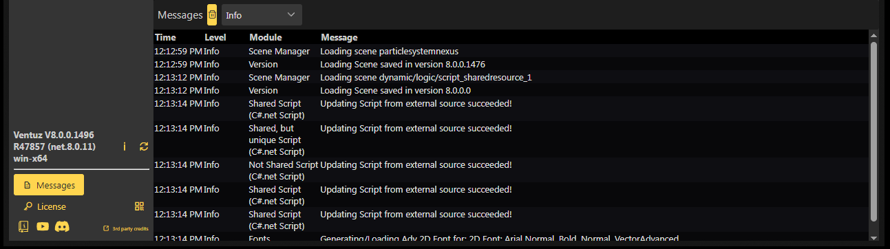

Messages
By pressing the Log button in the Live Options the current status of all streams (audio & video) is logged in the message window.
This information is only visible if the message level is set to info or debug. The message level can be set using the dropdown menu.
Changing an output stream for example or setting a new resolution will be written to the Messages.
For a GPU output the resolution and refresh rate will be printed, the input streams and other devices are written to the Messages log as well. With a running system this good way to get an overview of the configured devices.
More critical events are logged as Warning or Error.

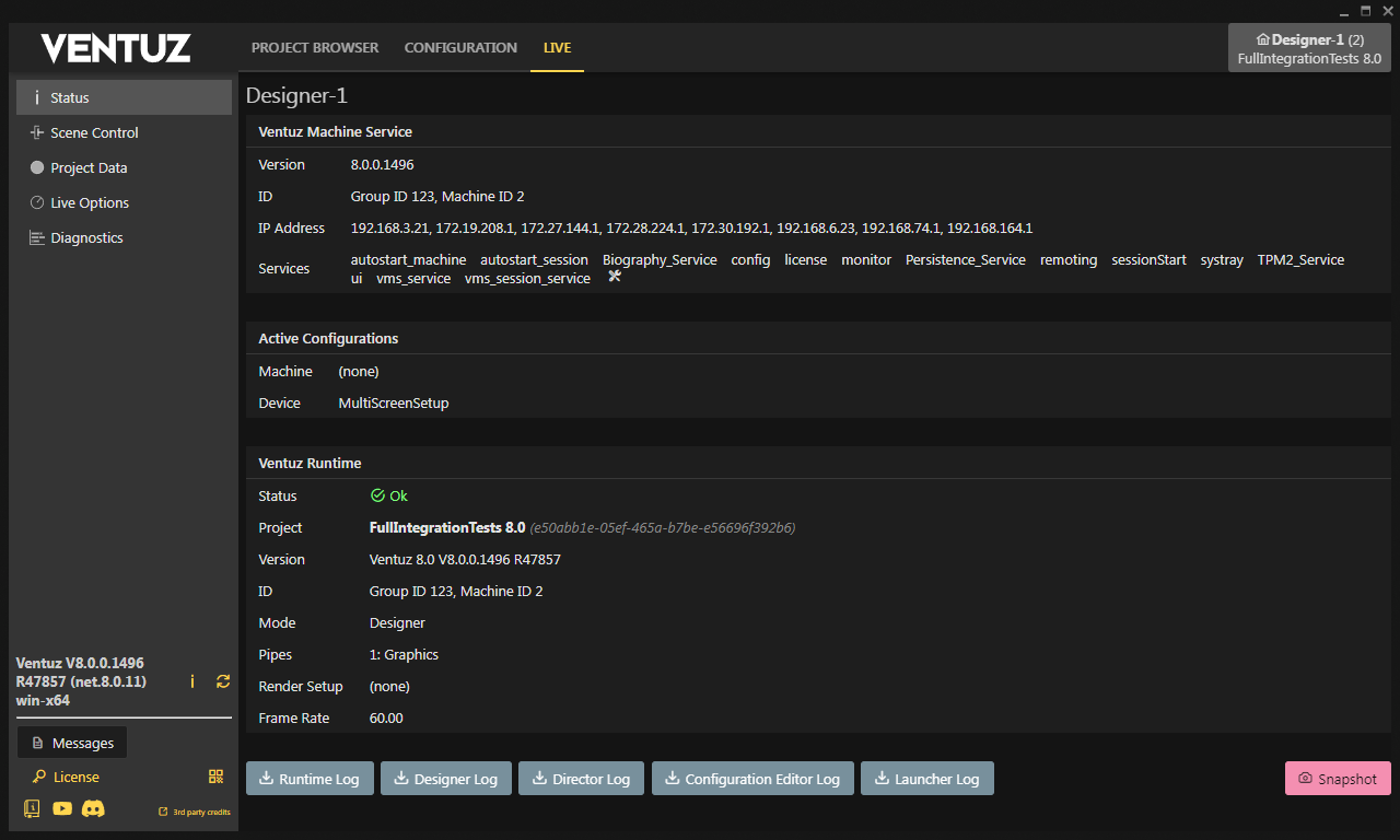

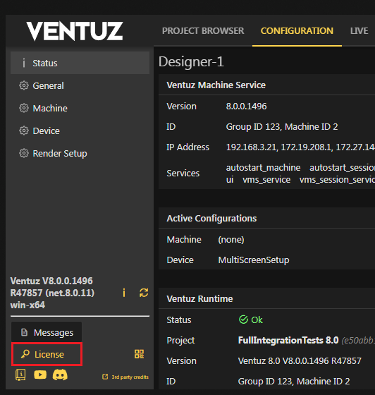

Status
The Status page from the Configuration or Live tab gives you detailed information about the current state of your selected machine(s).
This includes:
  • the ID and Group number
  • the IP Address
  • the currently running project
  • the installed Ventuz version
  • which product is running, e.g. Ventuz Designer
  • and the output pipe with the current frame rate and other configuration settings
  • overview of running VMS services and possibility to edit them
For more information on the different states that the VMS can be in, take a look at the VMS Documentation.
With the Snapshot button in the bottom right corner, a snapshot of the current Ventuz Runtime rendering will be displayed and is also downloadable.

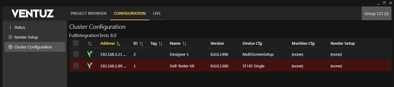

Cluster Status
If a Group is selected in the Machine Selection tab, this window will display the information overview of each machine in parallel.

License
License Manager
In the License section the system Ventuz license can be added, updated or unregistered.
This License Manager in the Configuration Editor has the some functionality as the standalone application installed with Ventuz.
With the Copy button all license information are copied to the clipboard.
Sometimes it might be necessary to press Update to reach out to the Ventuz License server to verificate your license after a change.

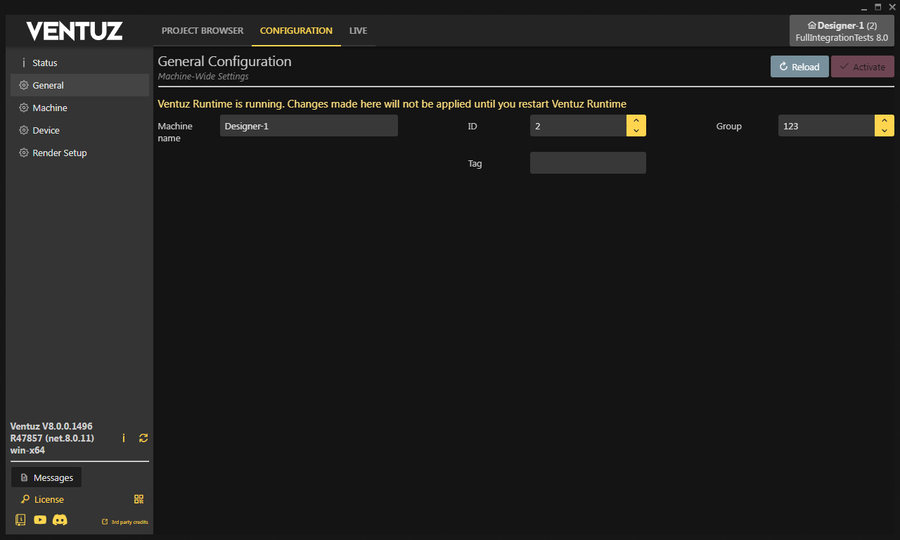

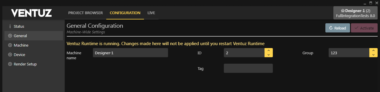

General Configuration
Overview
The General configuration tab contains information about the Ventuz Machine.
It defines the Machine Name of the machine as well its numeric ID and GroupID.
The ID determines which machine will be Master and which Client(s) in a Machine Cluster. The lowest ID will be set as Cluster Clock Master. The ID is also used to select the correct part to be rendered in the multi-machine Render Setup. With the Live Options, the ID can be changed while the runtime is active.
The GroupID must be set to a value greater than zero if a machine is part of a Cluster (group). Only machines with a GroupID can interchange their timing (cluster clock) to synchronize Remoting, animation and movie playback. For proper synchronization a valid Cluster Option is required.
The Tag is used by the Runtime to determine the Layout Scene that is to be used.

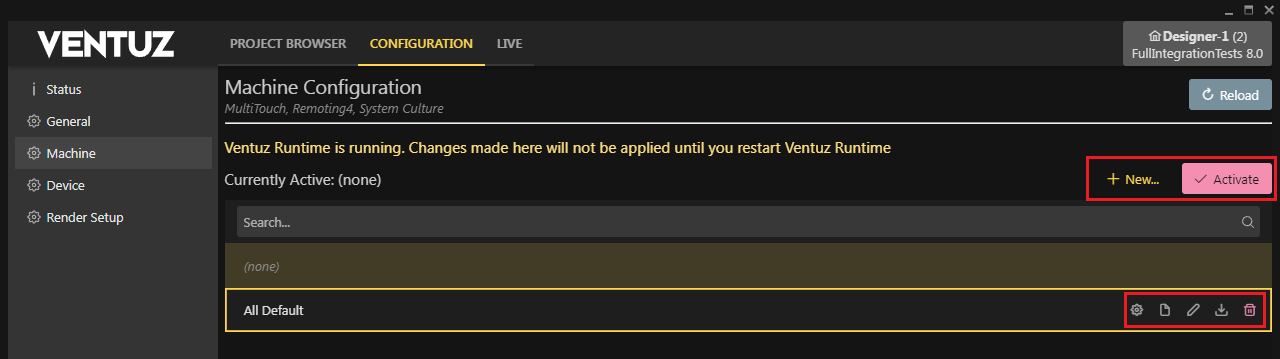

Configuration Files
The Machine Configuration and Device Configuration files are selectable and editable in the Configuration Editor.
New creates a new configuration file. It is possible to upload a file from the hard-disk, also a duplication of an existing configuration file can be done in the creation dialog. With Activate the selected configuration is activated and will be applied, also while the runtime is running.
With pressing the Cogwheel Icon the selected configuration will be opened in the editor. If you want to edit the configuration directly without the interface, you can edit the JSON file via the UI, by pressing the Paper Icon. With the Pencil Icon an existing, not activated, configuration can be renamed. With the next button the configuration file is saved to hard-disk. The Red Bin Icon deletes the configuration.
All Ventuz configuration files are stored in the system's public documents folder in the Ventuz8\Configuration directory. On most systems this path is:
C:\Users\Public\Documents\Ventuz8\Configuration\
Except the Render Setup files are stored within the Content\Project\RenderSetups folder structure within the Project.
If you upload your configuration file to a remote machine with creating a new configuration it will be saved at the remote machine locally in the same folder structure.

Group Selection
If a Group / Cluster is selected the General Configuration section shows an overview of the machines configuration.
It is possible to see the activated configurations and Render Setups for each machine and the VMS status for each machine. The machines can be sorted by each category. With the arrow at the end of each machine line, the Configuration Editor will switch to this machine for editing configurations.
The red marked bar indicates that status or the configurations of both machines is not according to each other. In this case the runtime of the first machine is not running.
