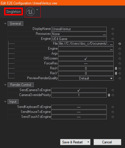

Singleton:

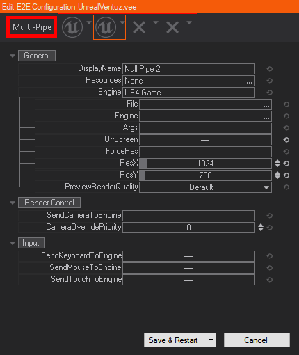

The configuration can be Singleton or Multipipe, that differentiation is needed to configure different Parameters for each Ventuz Render Pipe, e.g. a smaller resolution for the Preview Pipe or no external engine for the Preview Pipe at all (Null Engine).
Multi Pipe:
In some cases it makes sense not to start the same Unreal Engine Project with the same parameters like resolution for each Ventuz Pipe, which is the default case if you use Singleton. This is for sure the case if you want to use [Introduction Ventuz Director] in Preview/Program Mode to run your Virtual Studio. To do so simply  click the word Singleton to change the Mode to Multipipe.

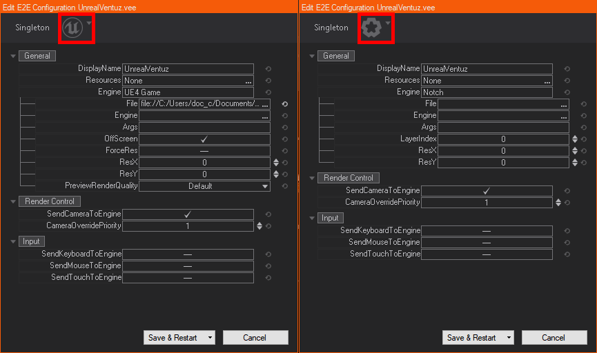

Engine:
There are 3 different types of Engine configurations you can currently use.
Null Engine mainly used in Multipipe mode to make sure no Engine Instance is started in defined Pipes
Unreal Engine Game Allows you to reference a .uproject or packaged game and change Parameters like resolution
Unreal Engine Live Link connects to a running unreal instance. Since no project or packaged file is referenced Ventuz cannot handle the engine process
Notch allows you to reference a .dfxdll, a so called Notch Block
Other Parameters:
See the differnces for the parameters set for each engine below:
The Paramters configured in the Editor are directly reflected inside the .vee file.
Display Name Changes the friendly name of this connection. Useful when working with multiple instances of an external engine. Especially when referencing the same project.
Send Camera To Engine If true sends the Ventuz Camera of the connected E2E Layer to the external engine and applies its matrices to the external camera automatically. Set to false if you want to handle this manually or want to synchronize cameras in the opposite direction manually.
Engine Specifies the type of the external engine. Set at the top of the window. See explanation above.
File Reference to the project or executable of the external engine.
Engine Reference to the executable of the engine's runtime or its editor. Useful if not defined in the project or if you want to overwrite the specification of the project.
Args Any commandline options that should be passed to the engine on startup. - not supported by Notch right now
Offscreen If set to true the external engine runs offscreen, thus creates textures but is not displayed on desktop.
Force Res Forces the External Engine to render in the specified resolution in ResX and ResY.
Resources Here you can select all assets that are needed for the external engine's project to run. These assets will be packed in a Presentation File, Scene Archive or Project Archive.
Keyboard/Mouse/Touch Input Sends the respective types of inputs to the external engine and ingests them into its input system - making it easier to pass interaction events.
Preview Render Quality Controls the external engine's scalability settings for connections to any Preview Render Pipe. This may save performance in e.g. Director setups. - not supported by Notch right now
Camera Override Priority Determines if this connection is the synchronization master. See E2E Layer Synchronization for more details.
LayerIndex applies to Notch only - here you set which layer of a Notch Block should be rendered.
