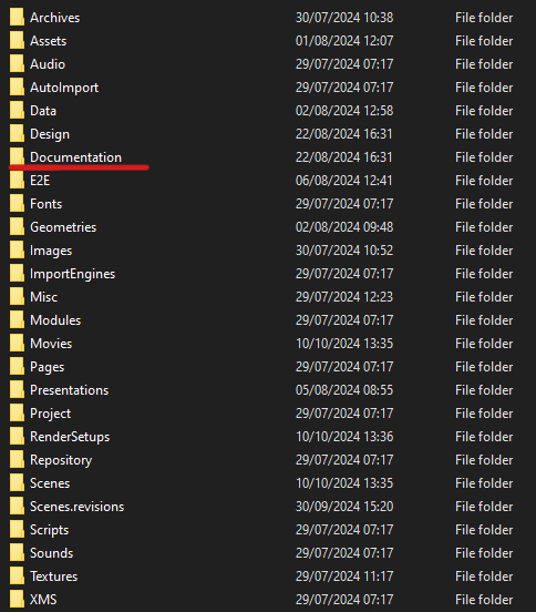

After you've created your project, some documents are automatically created and updated each time you close your project. You will find a Documentation folder in your project file structure where a project report has been created. If thats not case you can create the folder yourself.
Inside this folder you will need to create a index.md file. This can then be edited by your favourite text editor. We recommend notepad++. After you created the file and your Designer is running with that project you will see that a index.html is created automatically. If you Designer is not running it will be created as soon as you open that project. The html is needed so we can actually display it inside the Designer.
