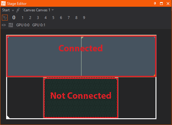

To use multiple Composition Layer, a Render Setup is needed so these can be correctly mapped on the physical outputs. You also have to make sure the Render Setup is activated, you can also check this by opening the Stage Editor. There it will show the currently active configuration. This is also where not connected Compositions are visible indicated by the noise pattern on it.

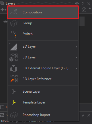

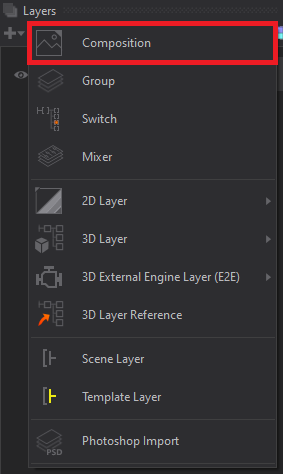

To insert a new Composition Layer use the new button for it inside the Layer adding menu

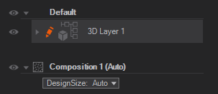

After inserting a Composition Layer you will see the Default Composition and the newly inserted Layer.
Again the noise pattern is indicating a not connected Composition. +Click on the small square to select the Composition needed.

Setting | Description |
Auto | Uses the given size from the Render Setup or Previs Canvas Node |
Manual | Changes to the given resolution and places the Composition onto the Canvas on the 0,0 position |
