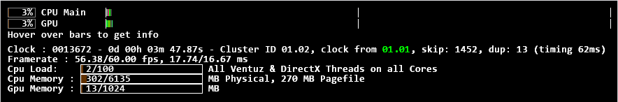

The value of a machine clock can be seen in the Performance Statistics overlay as soon as Cluster Support is enabled. The Clock row shows following values: 0013672 is the number of the rendered frames. 0d 00h 03m 47.87s is the duration this Ventuz instance is already running. Cluster ID 01.02 means that this Machine has the Group ID 01 and the (Machine) ID 02. clock from 01.01 means that the Cluster Clock is taken from the Machine with ID 01 in the same Group. If the machine uses its own clock, gray text color is used. If the machine uses another machine as timing master, green text color is used. skip shows the number of skipped (dropped) fames and dup shows the number of frames rendered with the same clock (no clock increase ways performed compared to previous frame).
When there is a tight timing synchronization between the display outputs, the font will be green. When the Clock UDP Package is coming from the master and does not reach a client in time, the font will change to gray and often change back to green a few frames later. In the basic cluster setup, this happens quite frequently as the hardware displays are not synchronized to present their content at the same time. Therefore one machine might start rendering a frame slightly before another. As long as the interruption is only for a frame or two, the visual result may still be acceptable as the machine will continue using its own internal clock to generate the correct time for the next frame.

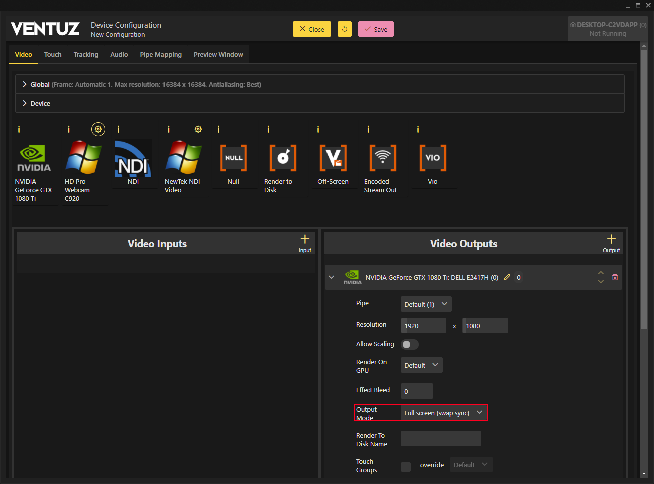

This also means, configuration of the synchronization boards is done in the graphics card driver, while Swap Sync needs to be enabled in the Video Device Output Mode.
