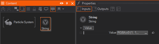

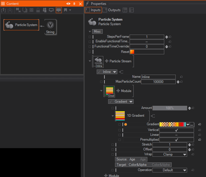

We will create several Gradients and therefore work with the Color Gradient Editor, also a good thing to know is that you can make use of a String node to Get and Set Gradients. You will see a Gradient String inside of collapsible elements like the following one.
Copy and paste the content inside a string node String node
Custom Gradient String - Test
RGBA;c0:(1, 1, 0);c0.1803922:(0.9176471, 0.4117647, 0);c0.3529412:(0.7244582, 0.3250774, 0);c0.3529412:(0.9372549, 0.827451, 0);c0.5568628:(0.9568627, 0.4, 0);c0.7098039:(0.9568627, 0.8313726, 0);c0.7098039:(0.6266181, 0.2619469, 0);c0.8745098:(0.9568627, 0, 0.07843138);c1:(0, 1, 0.9647059);a0:(1);a0.2745098:(0.1215686);a0.3568628:(1);a0.4666667:(0);a0.6156863:(1)
Bind the Gradient Property to the String node.
The Gradient will then use the content of the String node and you have a customized Gradient. You can delete the String node afterwards.

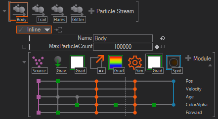

We will work in a Standard 3D-Layer, use a Particle System node and create four Inline Streams. The four streams are named: Body, Trail, Flares and Glitter.
Start by dragging and dropping a ParticleSystem into the Hierarchy Editor and select the First Inline Stream:
The Body
This is the Mainbody of our Firework and will be the longest stream. Rename the Inline Stream to Body.The Body is made of a Source emitter , Directional Gravity modifier , Gradient , Link Out , again a Gradient followed by a Simulation Module , another Gradient and a Sprite renderer.

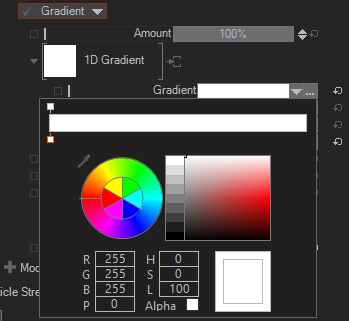

Gradient:
Plain White - Remove all the stops so that just a white gradient is left.
Property Value
Operation Overwrite
Its important to set the Operation to Overwrite. If you use the Gradient inside a simulaion loop you must set the operation to overwrite, else the color will be multiplied and it just takes seconds until the color is black! A red warning message will appear to help noticing whenever this happens.

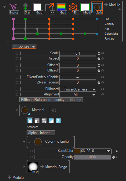

Sprite Renderer
Unfold the Materialstage with the default sprite (alphaglow_full.png) and set the color to:
Property Value
BaseColor 66,39,0
We have used a lot of Modules and Values right now. Lets go trough the "what and why": The SourceEmitter has been set to shoot a Particle every 4 seconds (0.25 / Second) with an overall speed along the Y axis of 7. With the Random Speed we have managed it that the Particle will not only go straight up, it will vary for every shot.

The Sprite, which will render a simple alphaglow on the screen has been adjusted to a slight orange.

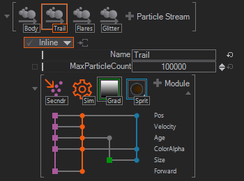

Time to create the Trails that are the burning propellant of the Rockets Body. The trail will constantly emit from the Body position and the black powder will fade off after a while. Create a new Inline Stream, name it Trail and use a Secondary emitter, Simulation , Gradient modifier and a Sprite renderer.
Use the following Values for the Emitter and Modules:
Secondary emitter:
Property Value
LinkName Body
RandomPosX 0.1
RandomPosY 0.1
RandomPosZ 0.1
RandomSpeedAll 0.2
Rate 250
Lifetime 0.5
RandomLifetime 65%
Jitter 1
Simulation:
Nothing changed
Gradient:
Property Value
Source Age
Target Size
Sprite:
As with the Body- Sprite, Unfold the Materialstage with the default sprite (alphaglow_full.png) and set the color to:
Property Value
BaseColor 66,39,0
What and Why:
Now we used a Secondary Emitter as the Particle Source. The advantage of the Secondary Emitter in this case is that we can use a "link" and make use of another particle's position. Therefore we used the LinkName Body, this created a link between the body- and the trailemitter. Technically it reads out the Buffer called Body which holds information like: Position, Color and Forward Vector.
The Simulation makes it possible to modify the particles in realtime and make the trail follow the body.
The gradient is used like a curve-editor: we set the source to the Age and the target to the Size of the particles. With the gradient itself we define vaules. The Gradient will be used as an "Over time..." module now. So the White at the beginning of the gradient will indicate that the particles are at the biggest size, while at the end of their Lifetime the Black will scale the particle down to zero.
The rendered particle again is set to the same slight orange color as the body.

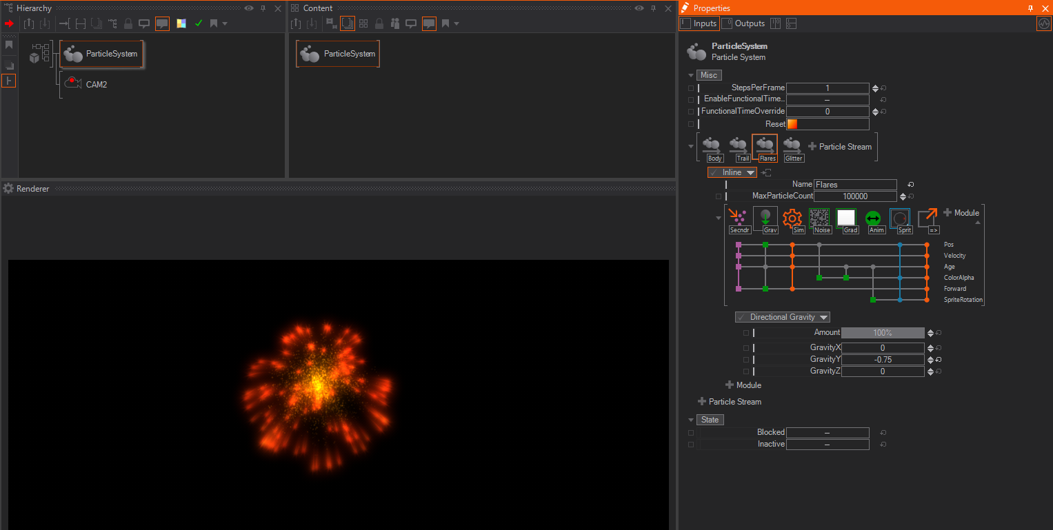

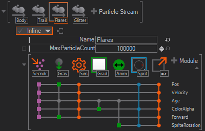

This will also be a long Inline Stream. Create a new Inline Stream named Flares with the following emitter and modules: We need a Secondary emitter, Directional Gravity module, Simulation , a Gradient and an Animation module, a Sprite renderer and Link Out .
Secondary Emitter:
Property Value
LinkName BodyDead
RandomPosShape Bouble
RandomSpeedAll 2.2
RandomSpeedShape Bouble
Rate 0
Burst 100
Lifetime 3
RandomLifetime 33%
Jitter 1
Directional Gravity:
Property Value
GravityY -0.75
Simulation:
nothing Changed
Gradient: Just a Custom Gradient, which can be used with the Copy&Paste into a String node technique.
Flares: Color&Alpha Gradient String
RGBA;c0:(1, 1, 1);c0.8588235:(0.9490196, 0.9490196, 0.9490196);c1:(0, 0, 0)
Animation:
Property Value
Source Age
Target Sprite Rotation
Base 0.5
BaseRandom 2
SpeedRandom 1
Sprite:
Property Value
Scale 0.575
New Material Stage - Base&Alpha and use the Spike Star Texture
Link Out:
Property Value
LinkName Sparks
What and Why:
Again we used a Secondary emitter which was bound to the LinkName BodyDead. Whenever a Body dies it will start to emit - in our case Burst - around 100 Particles. The RandomSpeed was set to 2, which will shoot the particle burst in all directions. Since we used Bouble for the RandomPosShape, the particles will not emit in a real spherical manner, the Bouble will distribute the particles more uneven. The same goes for the RandomSpeedShape. We also set the Burst instead of the Rate, since we want to have a real Burst for one time instead of a constant emmiter with a rate. RandomLifetime has been set to 33% which will let the overall emitted particles die randomly - 33% earlier and later.
Gravity has been set to a low minus value (-0.75) which will pull the particles/flares a bit down, but not as heavy as the earth-like gravity.
The Simulation is mandatory.
With the Gradient, which is set to have a fade-to-black it at the very end, we manage it to have the particles to fade out at the end of their lifetime.
The Animation has its Target set to the Sprite Rotation. We modified the BaseRandom to 2, the result is now a Value between 2 and -2. So each emitted particle will have a random rotation at the beginning. By setting the SpeedRandom to 1 the particles will rotate either clockwise or counterclockwise with a random speed value (again between a range of -1 to 1).
As Sprite we selected the internal resource SpikeStar and used a Scale value of 0.575.
The Link Out LinkName is Sparks since we want to use a Secondary emitter that will create the glitter which some people like to call "golden shower firework sparks".

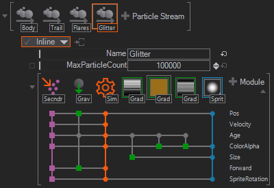

The last stream of the whole particle system. The Glitter is a lot of small sparks that fall down like the famous golden shower effects for fireworks. The Glitter is made of a Secondary emitter , Directional Gradient , Simulation , three Gradient and a Sprite renderer .
Secondary:
Property Value
LinkName Sparks
Rate 50
LifeTime 4
RandomLifetime 59%
Jitter 0.606
Property Value
GravityY -0.271
Simulation:
Nothing Changed
Gradient:
Property Value
Target Size
Glitter: Size Gradient String
RGBA;c0:(0.372549, 0.372549, 0.372549);c0.07843138:(0.827451, 0.827451, 0.827451);c0.2627451:(0.6668763, 0.6668763, 0.6668763);c0.2745098:(1, 1, 1);c0.3254902:(0.6122126, 0.6122126, 0.6122126);c0.4745098:(0.4823863, 0.4823863, 0.4823863);c0.4862745:(1, 1, 1);c0.5137255:(0.2588235, 0.2588235, 0.2588235);c0.6117647:(0.2066414, 0.2066414, 0.2066414);c0.6156863:(1, 1, 1);c0.6627451:(0.1795067, 0.1795067, 0.1795067);c1:(0, 0, 0)
Gradient:
Used as Constant Color
Colorvalue 155,110,28
Property Value
Source Age
Target Color&Alpha
Operation Overwrite
Gradient:
Another Custom Gradient
Property Value
Source Age
Target Color&Alpha
Glitter: Color&Alpha Gradient String
RGBA;c0:(0, 0, 0);c0.1372549:(0.1568628, 0.1568628, 0.1568628);c0.1411765:(1, 1, 1);c0.1686275:(0.3568628, 0.3568628, 0.3568628);c0.2627451:(0.7568628, 0.7568628, 0.7568628);c0.2666667:(1, 1, 1);c0.2901961:(0.7098039, 0.7098039, 0.7098039);c0.2901961:(0.4980392, 0.4980392, 0.4980392);c0.4588235:(0.5568628, 0.5568628, 0.5568628);c0.4666667:(1, 1, 1);c0.4862745:(0.5137255, 0.5137255, 0.5137255);c0.5921569:(0.4235294, 0.4235294, 0.4235294);c0.5960785:(1, 1, 1);c0.6196079:(0.3803922, 0.3803922, 0.3803922);c0.6980392:(0.3176471, 0.3176471, 0.3176471);c0.7098039:(1, 1, 1);c0.7333333:(0.2666667, 0.2666667, 0.2666667);c1:(0, 0, 0)
Sprite:
Property Value
Size 0.05
What and Why:
For the Secondary emitter we have just made adjustments to the Rate and Lifetime to have long-lasting particles with a high variation in their RandomLifetime.
The Gravity has been adjusted to pull the particles gently downwards.
The first Gradient has a general fadeout but with very bright spikes in it just to have a more glitter-like effect which scales the particles up sometimes. Another Gradient is just to set a constant Color and Overwrites the actual color.
The last Gradient has again very bright spikes but is set to add onto the color. This produces a flickering effect which is common for a golden shower firework. The small particles will start to blink and flicker.
Sprite Size has been adjusted to 0.05 which is very tiny and will allow us to have a high amount of Particles on screen. On one hand we have a high amount of Particles on screen on the other we have them very tiny and blinking and flickering.

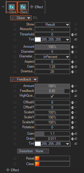

To have a bit more Glow and Effects applied we would add two layer effects to the 3D - Layer. The Glare and Feedback.
Adjust the FX like in the Screenshot below to enjoy a wonderful Firework Particlesystem with random Colors.
