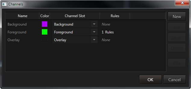

When creating a new show, by default, a channel is allocated for each Channel Slot in the active topology. Since the default topology is a local setup with just one Channel Slot, this results in the familiar setup a show containing only one channel. Additional channels can be added/removed via the Channel Manager at Show / Channels... in the main menu. Each channel has a name that is used throughout the application, a channel slot in the Topology active topology it is assigned to and an optional set of rules. When  double-clicking on a channel or selecting one and pressing the edit button, its properties can be modified.
The most important information for a channel is the Channel Slot it is assigned to. Without a channel slot, the channel will not be able to communicate with the rendering backend and therefore to cue/take any content.
Although the channel manager shows the names of the channel slots in the active topology, the channel stores the ID of the channel slot. This way different topologies can be used for the same show and channels will reconnect automatically if the new topology contains a slot with the same ID. If a slot is not available, the channel will log an error message that it is disconnected and show a red status message in the Timeline window.
Each channel can also be assigned a custom color. All windows that operate on a specific channel will color their outer border based on the channel's color. This is an optional feature but very useful when working with multiple playlist or property editor windows.

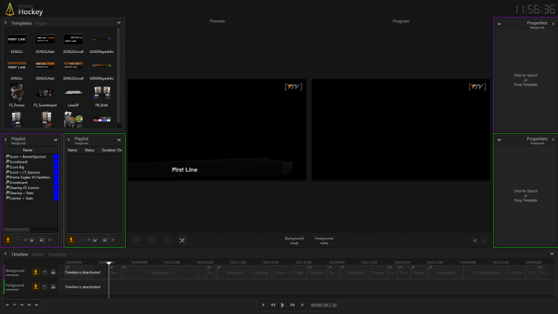

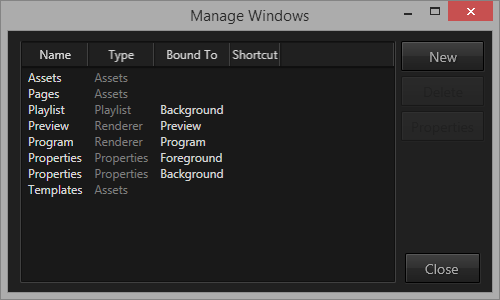

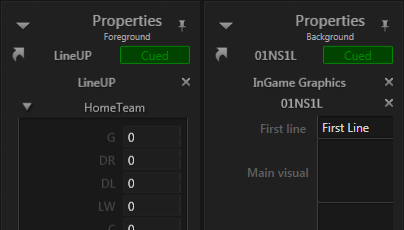

Some windows (e.g. the Property Editor, Playlist Window) require a channel to work on. Which channel a window is bound to can be changed in the Window Manager at Window / Windows ... in the main menu bar.
In the example above, two property editors have been added to the window layout, one is working in the channel "Foreground" while another is working on the channel "Background".
Since window layouts are shared among all shows based on the same project, a window does not directly bind to a channel but the index of a channel (e.g. is bound to the second channel in a show). The window manager just displays the current channel names for easier association.

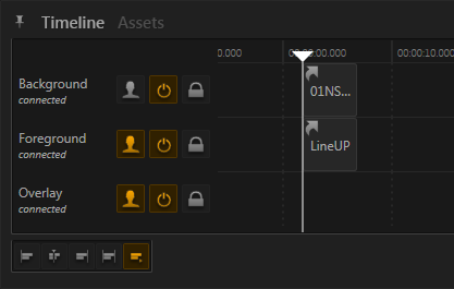

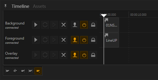

Each channel-based window contains a button showing a human shape to enable/disable user-interaction on that channel. If an operator cues a template, presses F1 or the take button in the Show Control, that action is performed on all channels that are user-interaction enabled. If for example one channel is automated via a Playlist, one generally will want to disabled user-interaction so pressing F1 will not disturb its operation. In the screenshot below, all channels have activated their Timelines but the first channel has its user-interaction disabled.
Although the user-interaction mode can be used to have a channel completely ignore all take/cue operations done by the user, there often are situations where one wants to do a take on only a specific channel. For this reason, the playlist, property and timeline window each have configurable button toolbars that can customize via the configuration option button in the top right corner of a dockable window. These buttons work exactly the same as the ones in the Show Control but act only on that specific channel.
The quickest way to activate a channel is by pressing Ctrl plus the number of the channel (e.g. Ctrl+1, Ctrl+2, etc). This shortcut will automatically de-activate all other channels unless the shift key is pressed also.

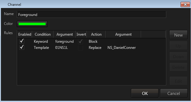

Let's look at an example: A channel called "foreground" has been given two rules.
The first rule restricts the channel to only cue content that contains the "foreground" keyword. Why is that? The condition "keyword: foreground" would usually match only content that contains the keyword "foreground". However, it is inverted, so the rule matches all content that does not have that keyword. And for all such content, the state is set to blocked, preventing them from being cued.
The second rule matches whenever the content contains the template "01NS1L". if so, it replaces parts of the content by the page "NS_DanielConner".
