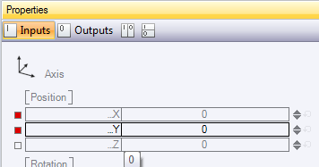

To externalize a member, click  on the small square button next to the label of the Property, Method or Event while holding the CTRL key to externalize it. The button turns red to indicate an externalized member. Such members are called Externals.

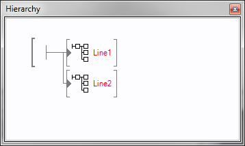

If the nodes that are providing these externals are located inside Containers, the containers themselves can be externalized as well. The container acts as a folder in that case. To externalize a container, the name of the container must as well follow the naming rules of externals before it can be externalized. Open the context menu by press&hold  on the container in the Hierarchy or Content Editor and select Externalize. The name label of the container turns red to indicate an externalized container level. All members externalized inside such a container will be located under this new folder:
/Line1/PositionX
/Line1/PositionY
/Line1/Text
/Line2/PositionX
/Line2/PositionY
/Line2/Text
Of course multiple nested externalized containers are possible. It is highly recommended to use folders to structure the scenes interface. Too much externals could make the handling very uncomfortable and name clashes could appear.

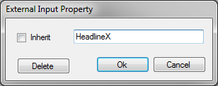

By default, members are externalized with their default member name (here PositionX and PositionY). This name can be changed by double-clicking on the red button. A simple dialog allows to assign a custom external name. To select the default name check the Inherit box.
To rename folders (containers) simply rename the externalized container in the Hierarchy or Content Editor by double-click  on it. One can also rename externals in the Externals Editor (see below).

To un-externalize a member either press Delete in the rename dialog or click  on the red button in the Property Editor. To un-externalize a container simply select Externalize in the context menu again.

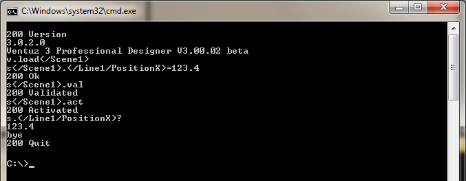

The current version of the Command Line Interface is not able to deal with multiple instances of the same Scene, because Scenes are addressed only by their Scene Identity. Also Layouts with multiple Ports are not supported. Activating a Scene always uses Port !#0 - the default Port
Establish a connection to the target machine via telnet.
telnet hostname port(configured in the Machine Configuration)
Simple example of a CLI communication.
