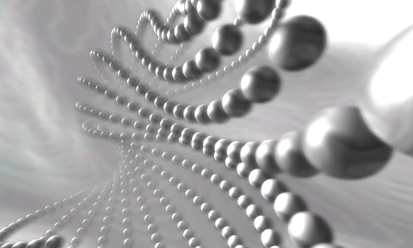

SpreadThe Spread node renders its children multiple times to create the illusion of duplicating objects without the added memory consumption of an explicit copy. Each instance can have a transformation (translation/rotation/scale) that offsets itself from the previous one, creating chain like structures.
When inserting the node into the scene hierarchy, the spreader can be created either with or without a Continue Output. All children under the Repeat output will be instantiated as described above. All children under the continue output will only be rendered once with a transformation applied that would be the same as the instance at Count.
