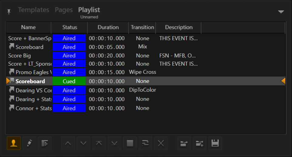

Each playlist entry has a status:
The status of a playlist entry - especially the Aired state - can be reset by selecting entries and then choosing Playlist / Reset Status from the main menu.

The toolbar at the bottom of the playlist window contains various operations that can be performed. Which buttons are shown can be customized via the docking window configuration options to fit workflow needs.
These buttons function exactly the same as those in the Show Control. However, they only affect the channel this playlist window is bound to.
These buttons affect the actual usage of the playlist:

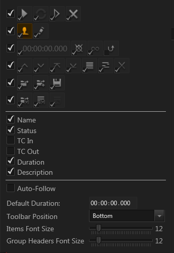

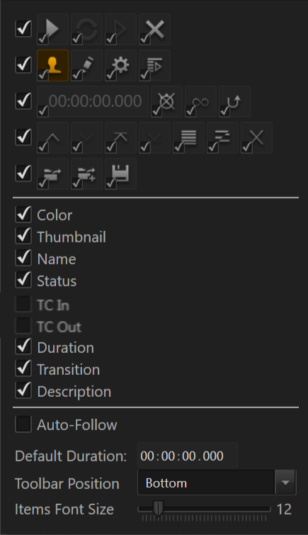

The Window Options allow you to enable and disable certain sections and buttons of the Toolbar and select the columns you want to see in your playlist.
Columns:
Misc:
