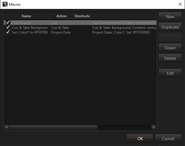

The Macros Editor Window will give you an overview of all currently defined macros. You can create a new macro by  clicking the New Button on the top right of the window.

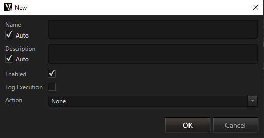

In the upcoming window you can define the Name and Description of the macro. By default these will be generated automatically based on the macro's effect. Enabled let's you temporarily disable a macro without having to delete it. If Log Execution is active the Ventuz Director will create a log message on execution with its Name, a unique identifier and all given parameters.

In the Macro Overview you can rearrange, Duplicate and Delete macros. If you need to change their behavior you can Edit them by  double clicking.
