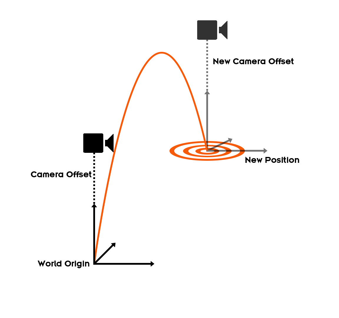

Due to its object-based behavior it has to be placed in front of Objects in your scene that you want to act as a walkable ground. Whenever a Single Tap Event is processed on that Object it will teleport the current Layer's Camera to the position of the Touch Teleport Node. This Teleport will preserve the current Offset of the Camera to the World's origin and apply it to the new Position - this is illustrated in the schematic below.
