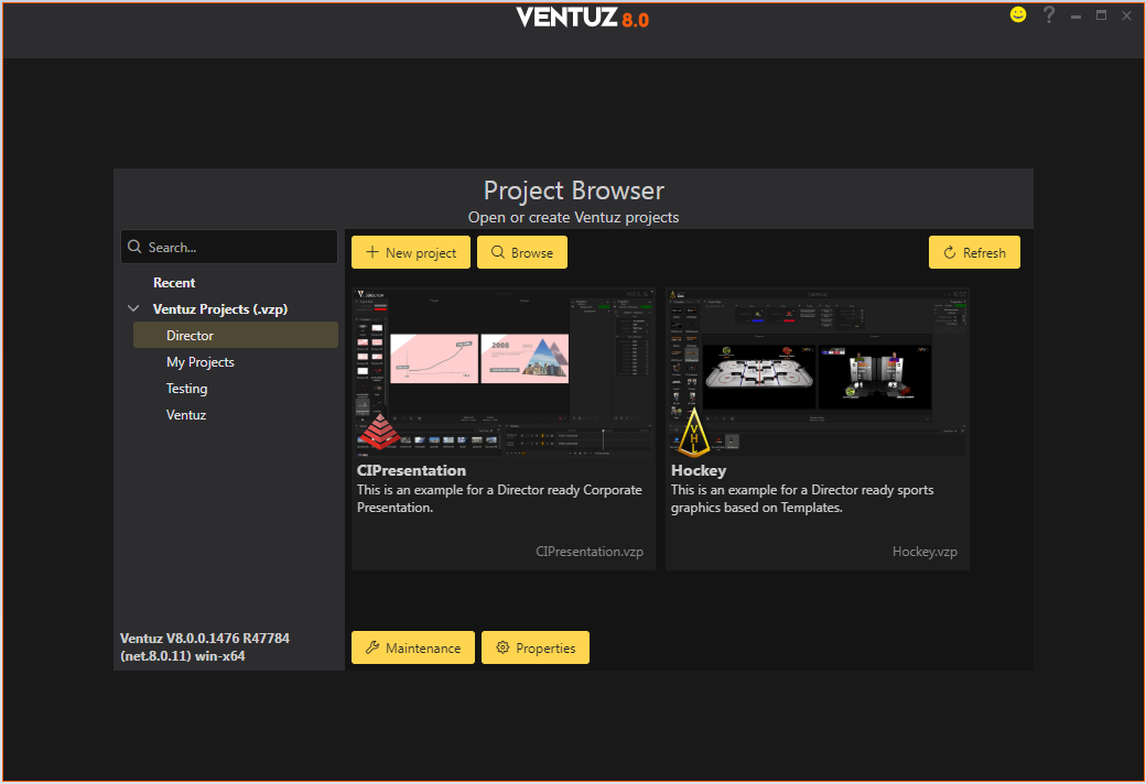

Upon starting Ventuz, the Project Browser will appear as the very first thing:

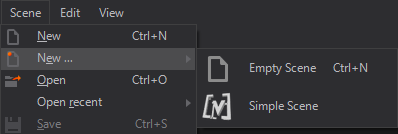

  • The first one is to create a new blank scene by selecting New from the Scene Menu. In an empty scene everything must be built from scratch.
  • The second way is to use the Create Scene Dialog by selecting New... from the Scene Menu or by clicking Create Scene in one of the Editors when no scene is open. The dialog will ask for the type of scene to be created. Scene types displayed in the dialog are either internal scenes (Standard) or scene-templates located in open Repositories.

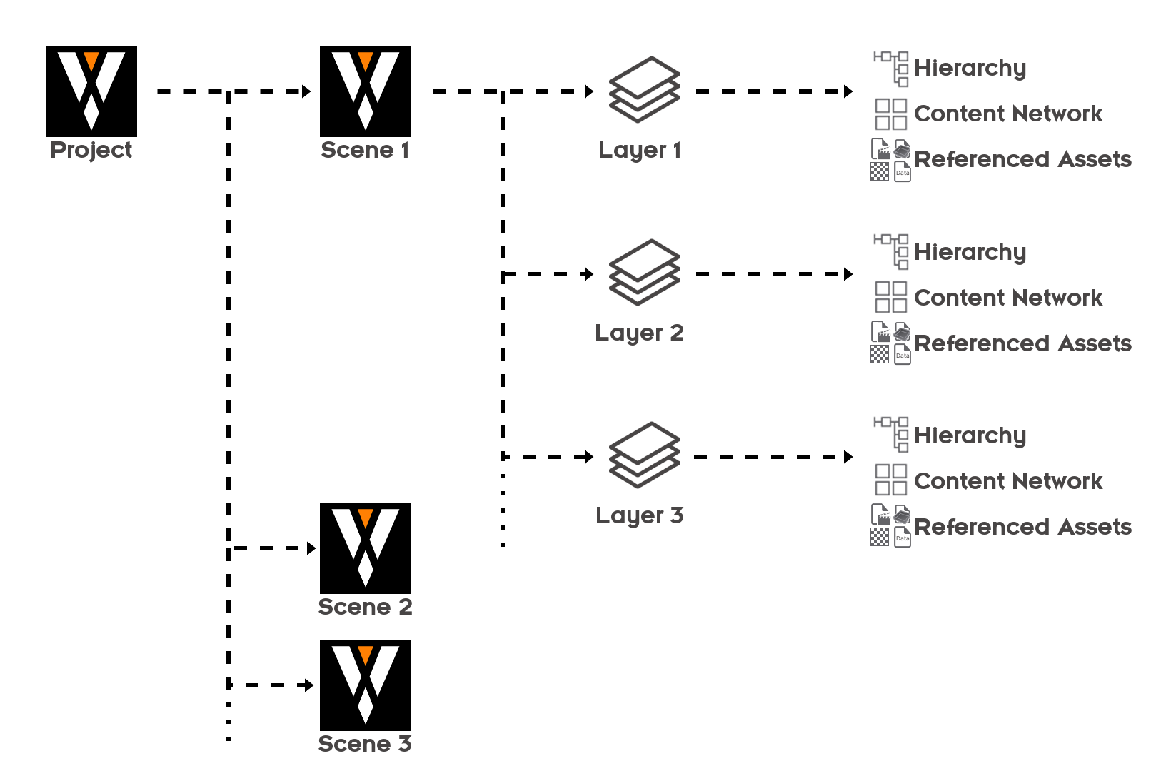

The graphic below illustrates the typical structure of a Ventuz project. Generally the Project consists of several Scenes that again consist of several Layers, be it 3D Layers or 2D Layers. Layers are a collection of Content Nodes and Bindings and - in the case of 3D Layers - Hierarchy Nodes. The Nodes are referencing any Assets needed by the logic of the scene.

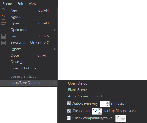

Ventuz provides a system to minimize the damage of unexpected application crashes and to keep track of scene file changes. To enable this system, open the Scene Menu and select the Load & Save category. There you find the AutoSave and the Create backup files option. The AutoSave mechanism will periodically save the current state of the open scene to the Scenes.revisions folder. The scene is saved under its current name with additional .auto extension.
The backup mechanism works as follows: every time a scene is saved (under the old name) by the user, a copy of the old scene version on disk is saved to the Scenes.revisions folder with an additional extension ####.bak. #### represents a number between 0000 and 9999. This number is incremented with every new save operation. If the maximum number of backup files is reached (as configured in the Load & Save Options) the oldest backup file (with the lowest index number) is deleted before a new backup file is created.
To open one of the Backup files or the AutoSave file open the Open Scene dialog and choose the desired scene version in the Revision drop-down box at the bottom of the dialog. Note that if such a backup scene is saved in the Designer, it is saved under its original name in the Scene folder - this does not overwrite the backup file!
