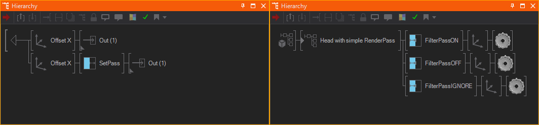

In the screenshot below render passes are applied to three objects. In a hierarchy container with linked outputs, one of the subtrees contains a Set Pass. The Filter Passes on the objects determine whether the object traverses this subtree or not.
A possible scene setup for this is shown in the figure below. The 'Head with...' container has two linked Outputs: a normal one and one with a Set Pass. The normal 'upper' pass is traversed if the Filter Pass node is set to Off or Ignore. The 'lower' pass is traversed if the Filter Pass node is set to On or Ignore.
