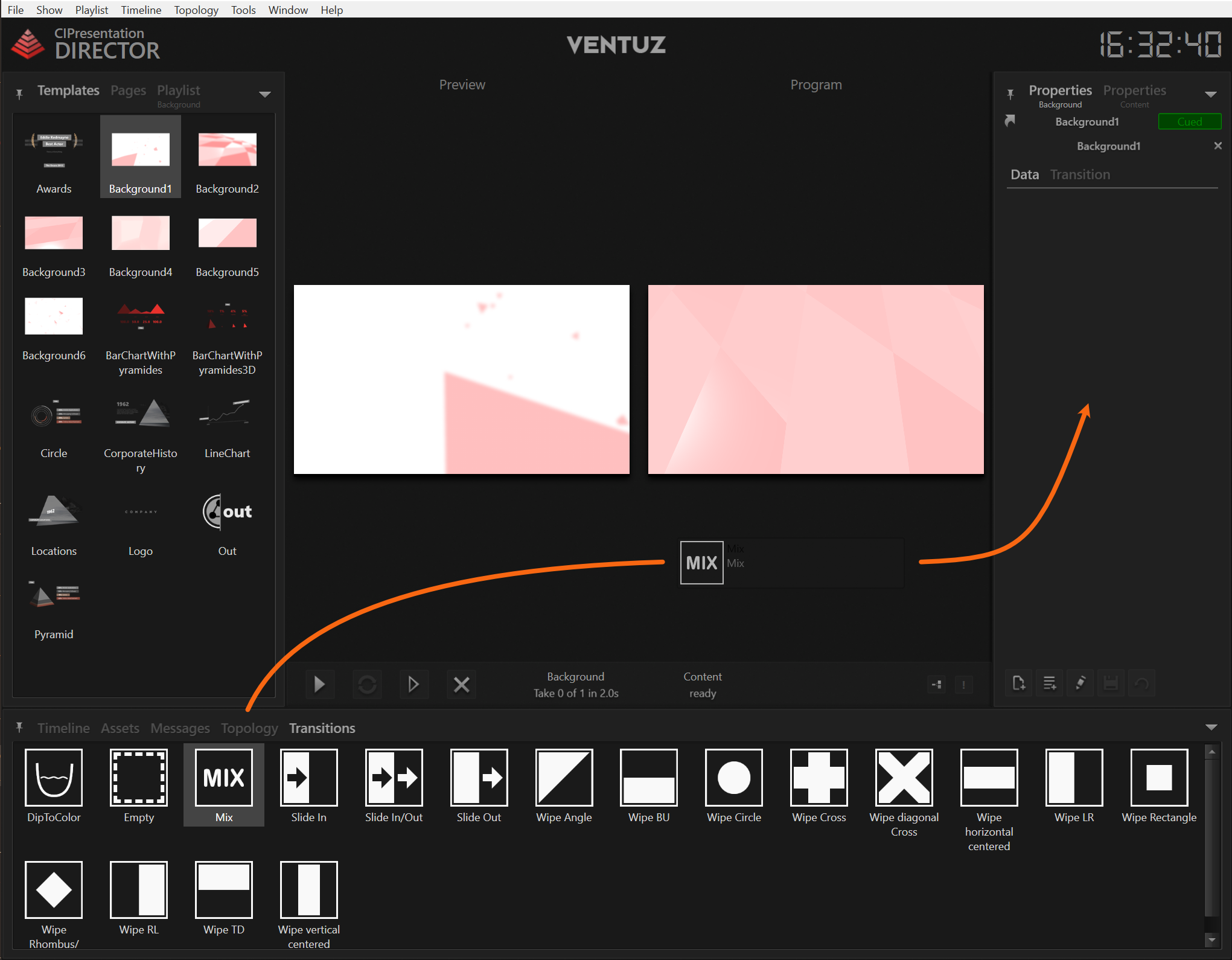

The Transitions are located next to the Assets window in the default layout. To enable or disable the Transitions window,  click the Window menu and  click Transitions. Each transition is represented by a thumbnail, a title, and a description, similar to how Templates are displayed.
To add a Transition to a Template, follow one of these methods:

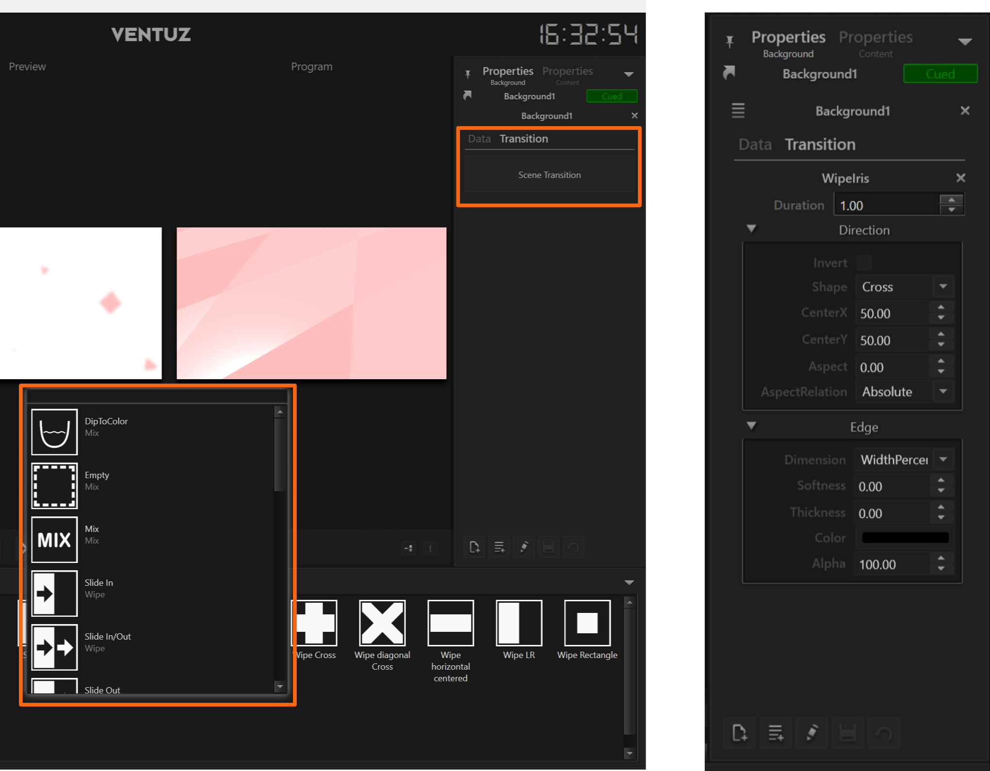

Drag and Drop: Cue a Template, then  drag and drop the desired Transition onto the property editor. Using the Transition Tab: Open the Transition tab in the property editor of the cued Template, click Scene Transition, and select a Transition.
With a cued Transition, the configuration of the Transition, such as its duration or other specific settings, is adjusted in the Property Editor.
