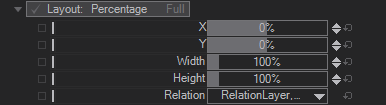

The properties of a Property Group are indented. The name of the Property Group Option and the Property Group are highlighted with a box like seen in the image below showing the Percentage Layout Property Group of a Layer. Next to the Property Groups name you can often see a short description of the Property Group's settings.
