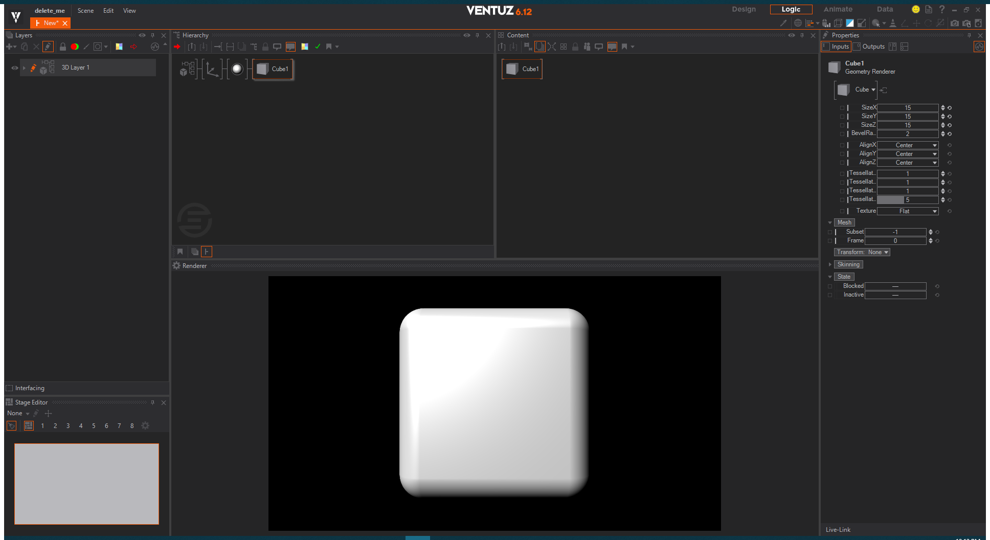

Open Ventuz Designer. Start a new project and give it a title. In this example VentuzVertex is used as the project name in the Ventuz default save location: C:\Users\Public\Documents\Ventuz6\Content\Projects\. This is very important for later.
Ventuz will load a blank scene.

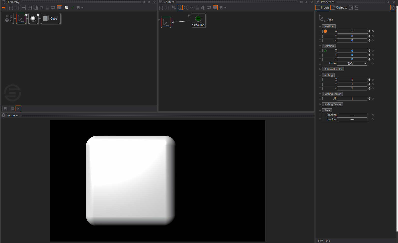

  1. Add an Axis Node to the Hierarchy tab.
  2. Add a Color Node to the Axis Node
  3. Add a Cube Node to the Color Node
  4. Change the size of the Cube to 15 x 15 x 15
  5. Set the BevelRadius to 2.
  1. Click on theAxis Node in the Hierarchy Area.
  2. In the Content Area, create and connect a Mover Node to the X Position Property.
  3. Set the Min of the Mover Node to -5 and the Max to 5.
Now there is a moving Cube in the render window.

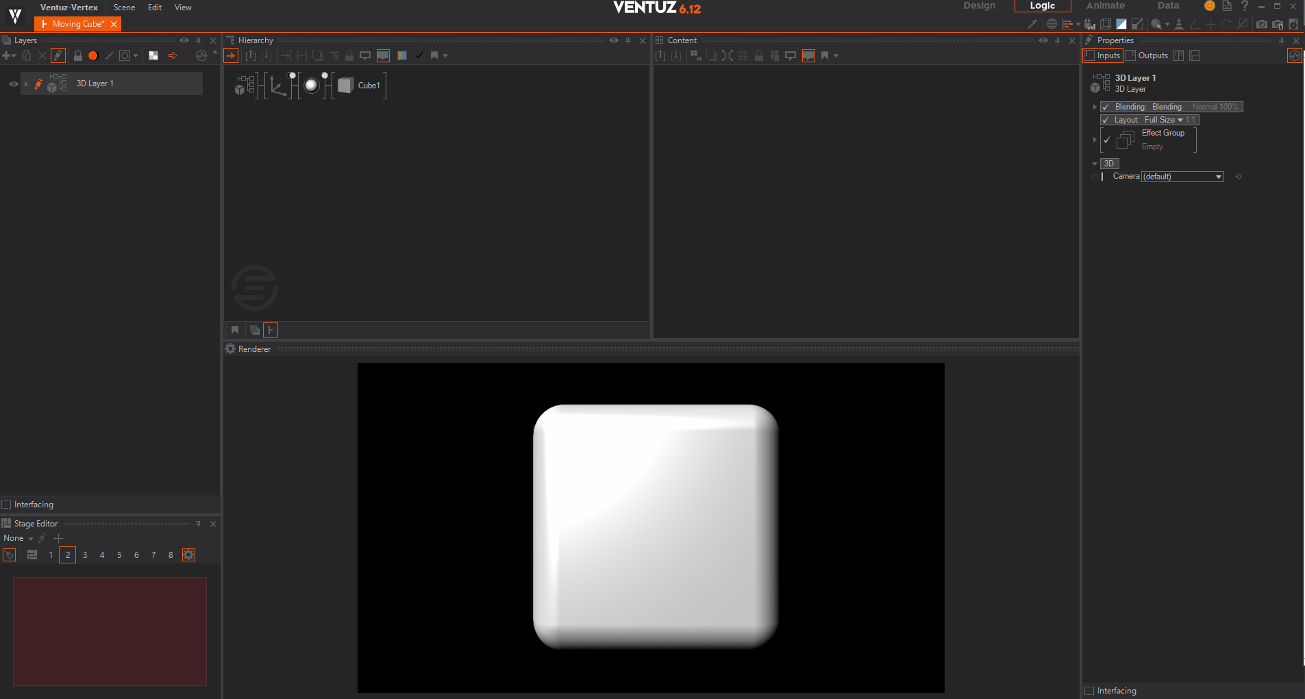

Adjust Scene for Vertex Timeline Operation
To make a Ventuz scene compatible with the Vertex timeline based workflow, Keyframes must be added to the Ventuz Scene.
The Main Timeline in Ventuz must be used for this integration.
  1. Click Animate at the top right of Ventuz window. This will change the workspace to a setup better suited for working with the timeline and keyframes.
  2. With the Axis Node selected,  Drag the X Rotation and put it into the timeline area.
  3. Add a keyframe by  Click the Orange + button. Or Insert.
  4. Move down the timeline and add another keyframe.
  5. Change the value of the X Rotation parameter to 360.
Note - The length of the container in Vertex is determined by the length of the timeline (or space between keyframes) in Ventuz. A 2 second timeline in Ventuz means a 2 second container in Vertex.
  1. Save the Scene.

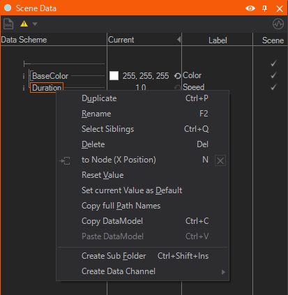

Setting Parameter Default
In order for Vertex to know what values to load when using exposed parameters, defaults to these values must be set in Ventuz.
  1. In the Scene Data Tab set the values as desired.
  2. Hover over the name of the value to set the default for and long  on this name.
  3. Select Set current Value as Default
  4. Repeat for each exposed value.
Setting the default will enable the "Reset Parameter" features to be used in Vertex.

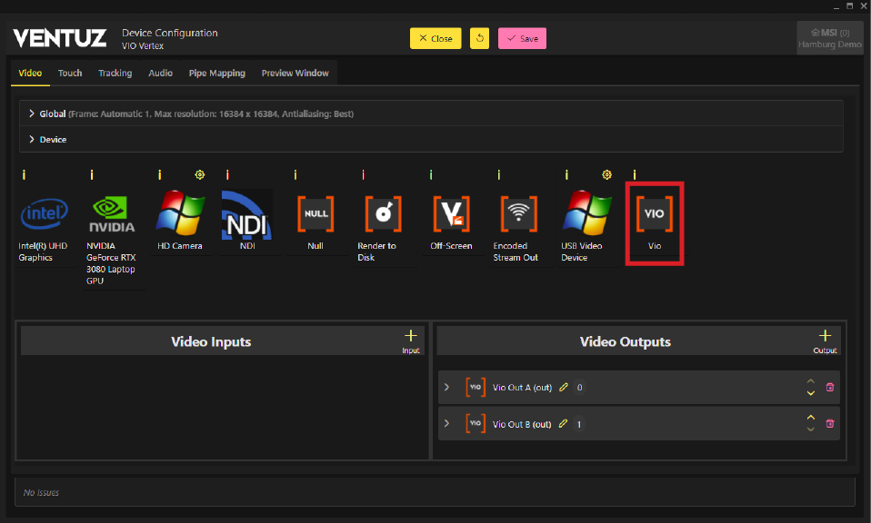

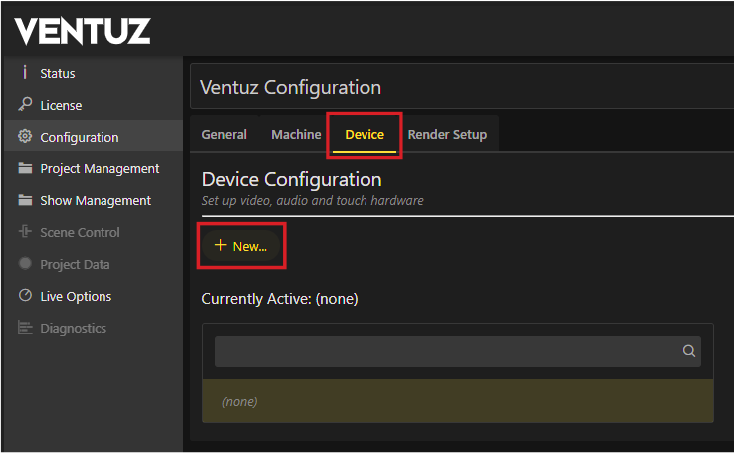

  1. Open the Ventuz Configuration Editor.
  2. In the left navigation pane,  Click on Configuration. This will open the Ventuz Configuration screen.
  3. In the top bar,  click Device.
  4. In the "Create Configuration" window, type in a name such as VertexVentuz or something similar and  click + Create.
    • The newly created configuration will automatically open.
  1.  Drag the VIO option to the Video Outputs area at least two times.
    • Do this as many times as needed to have multiple streams as mentioned above.

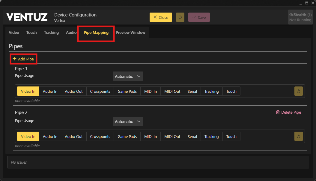

Next, you will need to add a Pipe. A Render Pipe can be seen as another instance of the engine within the Runtime. Each Pipe can hold one Scene, which is important for both displaying multiple Scenes at the same time, pre-loading Scenes before they need to play, and for enabling smooth transitions between Scenes. Read more about Render Pipes here.
  1.  Click on Pipe Mapping in the top bar.
  2. Click "Add Pipe" two times to add the minimum number of required Pipes.
  3. Add additional pipes as needed.
  1.  click Save and Close the Device Configuration Window with the Close button.
  2. A window will ask if the new configuration should be activated.  click Yes, Activate to continue.

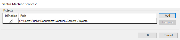

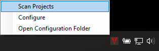

By default, the Ventuz save location is seen and will be scanned by Ventuz Runtime; this is necessary to enable Vertex to load Ventuz Projects and Scenes.
If the project was saved in the default Ventuz folder C:\Users\Public\Documents\Ventuz6\Content\Projects follow these steps:
  1. In the Windows System Tray,  Click on the red Ventuz Logo.
  2.  Click Scan Projects
If the project and scenes were not saved in a the default location:
  1. In the Windows System Tray,  Click on the Ventuz Runtime Logo
  2.  Click Configure
  3.  Click Add
  4. Navigate to the custom save location.
  5. Add the parent folder to the project folder, not the project folder itself
  6.  Click Ok to add the folder
  7.  Click Ok to close the configuration window
  8. In the Windows System Tray,  Click on the red Ventuz Logo.
  9.  Click Scan Projects
Updates and additions to Projects that have been scanned do not require another scan. The same is true for adding Scenes to this project.

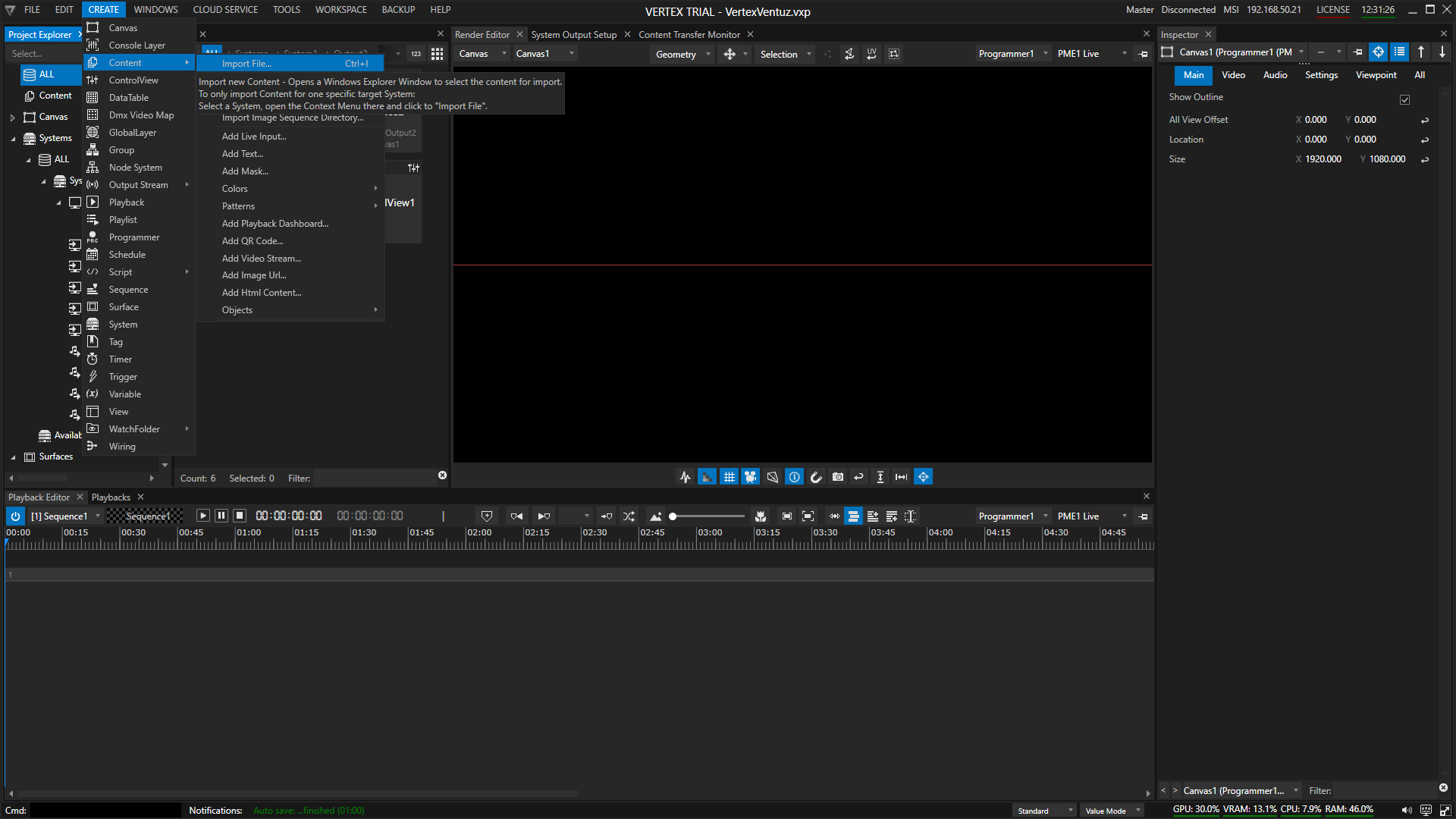

  4. Import the Ventuz Project
    • Open the File Import Window, either push CTRL + I. Or in the top menu bar,  Click CREATE -> Content -> Add File...
    • Navigate to the Ventuz project folder, named VentuzVertex, select and open the project file.
The VentuzVertex Ventuz project is loaded into Vertex inside of the Project Explorer. Double  on the Ventuz Project icon and the Scene(s) in that project will be shown.

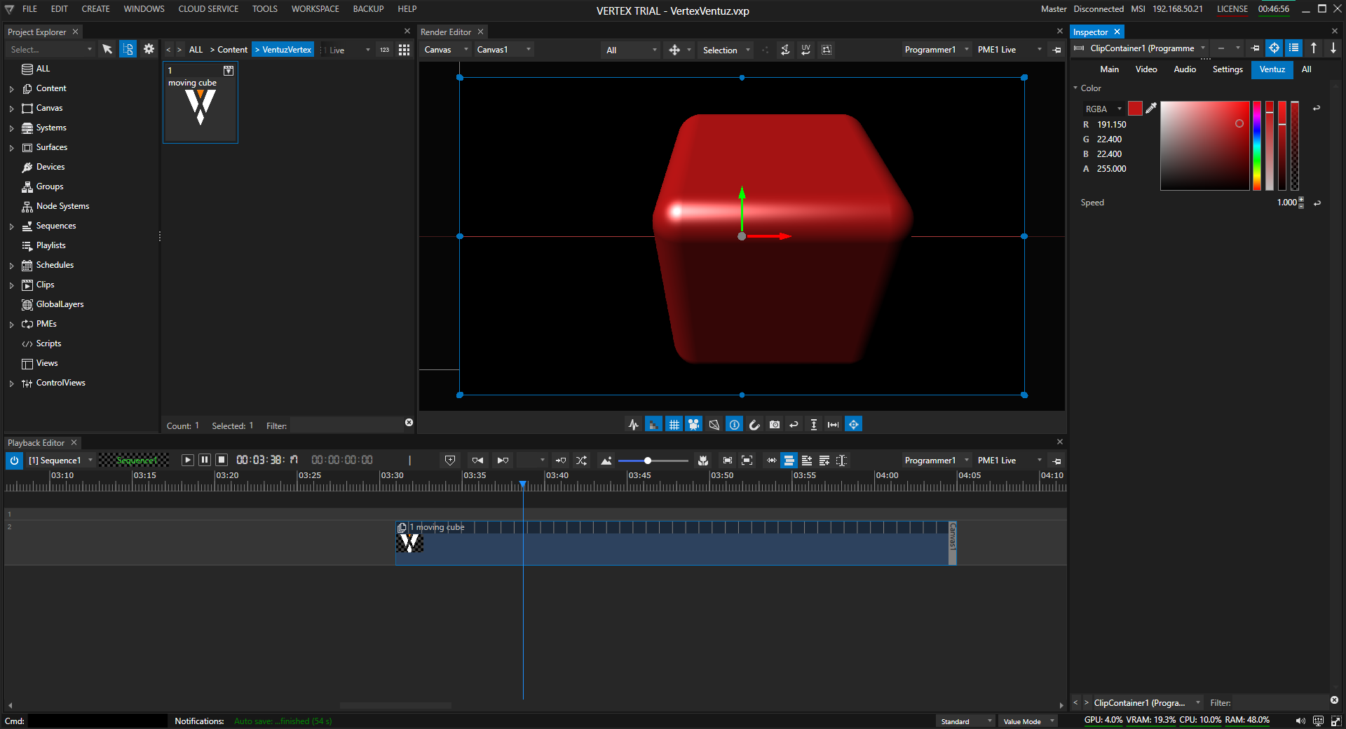

Controlling Parameters in Vertex
  1. Add the Scene to the timeline. Use the + button to zoom in.
  2. Hover over the edge of the container to extend it if needed.
    • changing the length of the container will speed up or slow down the time between keyfrmes. Any nodes such as movers or particle movement will not be affected by adjusting the length of the container in Vertex.
  3.  click on the Moving Cube in the timeline.
  4. In the Inspector  click on Ventuz.
    • Here, the Color and Speed values that were exposed in Ventuz can be adjusted.
    • These adjustments are being made real-time to the Scene in the Ventuz Runtime Engine; it's the same as changing the values inside of Ventuz manually.
