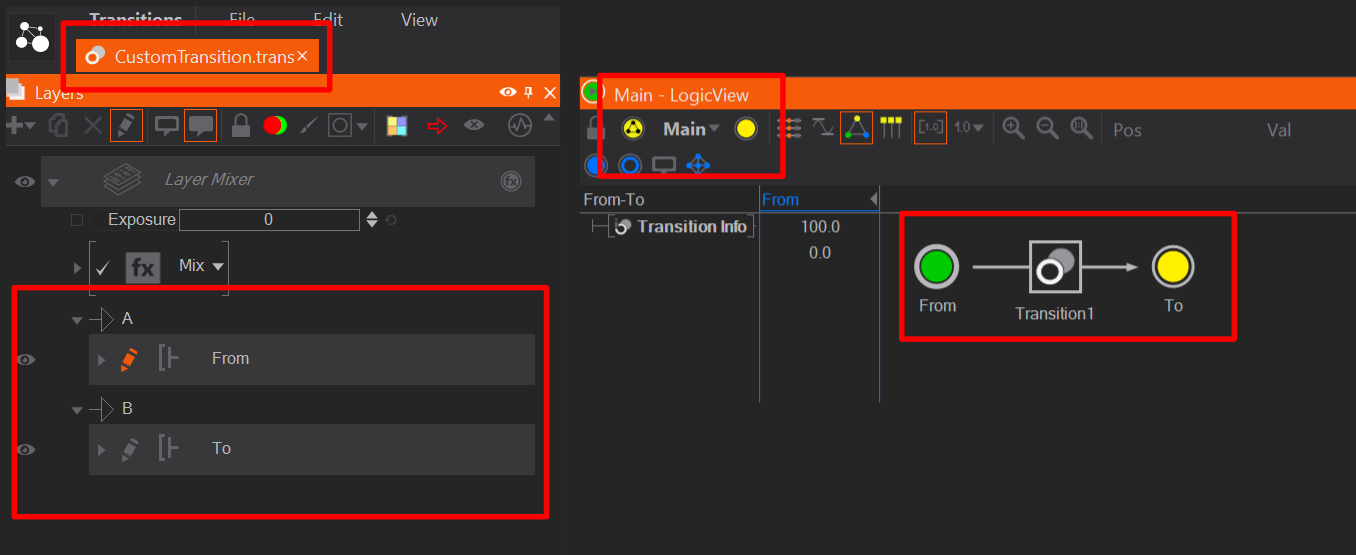

In this preset Scene, you will see the base requirements for a Transition Scene:
  • 2 Scene Port Layers. The first to hold the Program Pipe content and the second for the Preview Pipe.
  • The Main Animation is in Template mode and has a Begin State connected to a Present State.
  • The Scene is saved with .trans at the end of the name. For example: CustomTransition.trans.vzs This naming scheme is mandatory for Ventuz to recognize the Scene as a Transition! Removing the .trans in the name will change the behavior of the Scene to a standard Scene.
By default, the Template Scene Transition uses the Mixer Layer which helps to blend between two Layers. This is a very useful tool for nice blends, but it is not mandatory for the custom Transition to work.

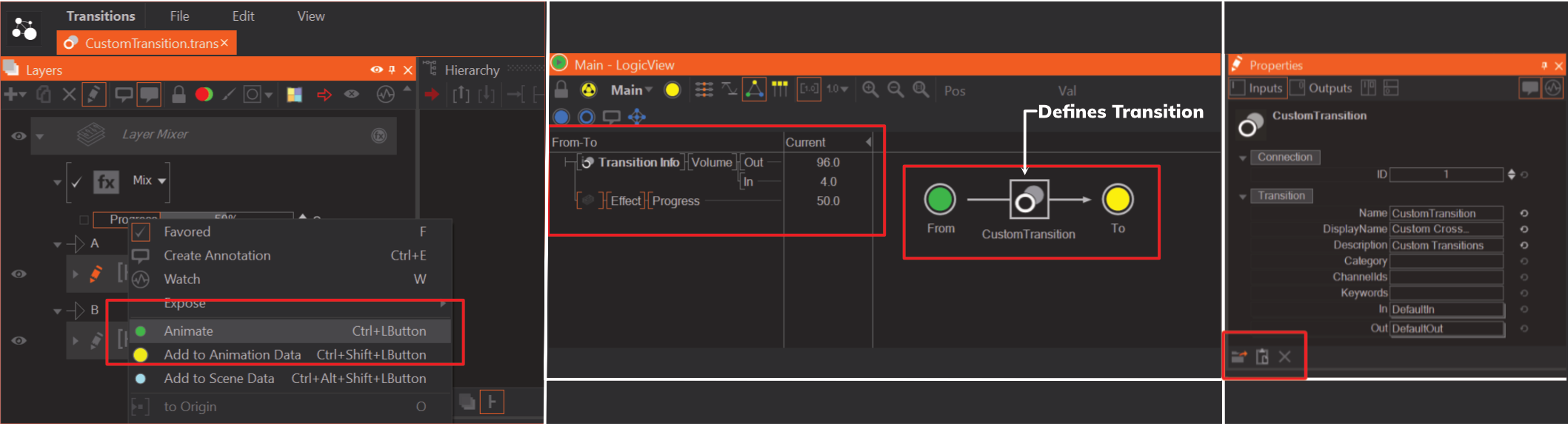

Thanks to the Mixer Layer, the cross-fade between two Layers is very easy. The default setting of the Mixer Layer is to Mix between both ports with the input Property Progress.
Add the Progress input to the Main Animation and animate it:
(Note: When using the Template Transition Scene this step and the following animation is already done.)
  1.  Click on Progress and  click Animate.
  2. Switch to the Animate Tab in the top-right menu.
  3. Navigate to the State Logic tab of the Main Animation.
You will find a Begin and a Present State and a connection between these two. The drawn rectangle in the middle of the connection represents the data of the Transition.  click on the rectangle to edit the Transition name and the displayed name for the Director UI. You can also use a description and a category. Similar to the Templates, Thumbnails can be added at the bottom of the Property editor.

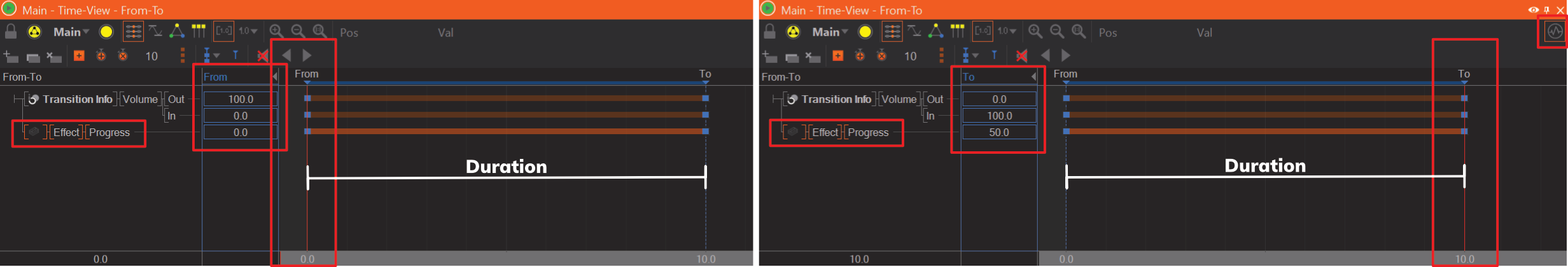

Since the connection between these two States represents our Transition, all our blending and animating has to be done here. We switch to the Timeline tab. (simply press T)
Note: It might be necessary to activate the Monitor Timeline and Value switch in the top-right corner of the Animation Editor, to see your timeline cursor moving.
There are already two channels in the Timeline. By default, these are bound to the Transition Info Node to control the audio level in the Scene Ports during the transition.
For the cross-fade, simply animate the Progress channel from 0 on From to 100 on To  click on the keyframe of From and set 0 and navigate with the timeline cursor to To and set 100.
In general, we always want From be solely visible on the beginning of the Transition and To solely at the end. This is necessary to have a issue-free Cue and Take process.
With space-bar you can trigger the playback of the timeline and see your animation. Alternatively you can move around with the cursor to manually watch the animation.
The general duration is defined by the length of the connection between the two States. Per default, it is set to 1 second. You will see To at the time marker of 1s or 10.0 (depending on your Timeline settings) To change the default duration, move the To (Present State). The timing also can be changed in the Director.

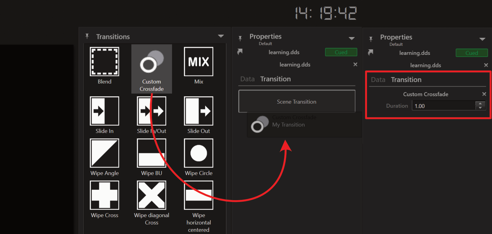

To add a Transition from one Template to another:
  1. Cue a Template
  2. Add your Transition from the Transition window to the Animation tab in the Properties window of the cued Template.
The Transition is always added to the cued item and defines how the Template comes in. So the Transition is always applied to the current content in the Program Pipe and the cued Template with the Transition.
The Duration property of the Transition overwrites the default timing. It simply stretches or squeezes the animation between the first and second State of your Transition. If you cue your Template or any item from the Asset Browser, like an image or video, and add your Custom Transition, you can see your Transition in action and have successfully built a custom Transition Scene!
