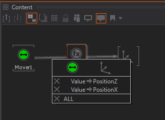

Two nodes are connected by a line if at least one property of a node is bound to a property of another node. The binding relationship can be bidirectional in which case both ends of the line have an arrow head. To remove a binding, click  on the line and a list of all bound properties opens. By selecting one of the entries, the respective binding will be removed. To remove all bindings of a node, select the node and press SHIFT + DEL or select Unbind from the Edit Menu.
Sometimes you want to add a node in between an existing connection of two nodes. To do so you can just grab a node from the Toolbox and drop it on a Binding if there is only one connection that fits the value type, the node is inserted, otherwise you get a list of available possibilities.

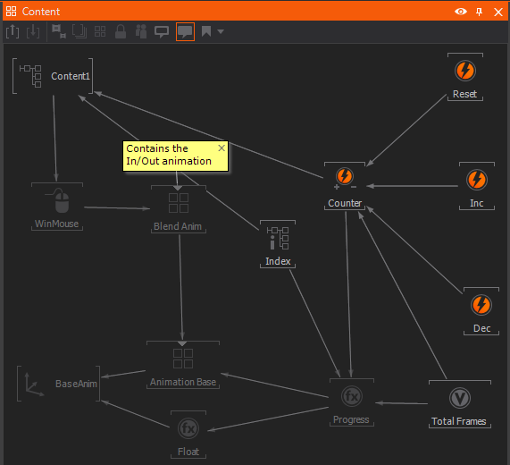

Annotations
When coloring is not enough, the user can also add a "note" to a node by selecting it and then choosing Edit Annotation from the toolbar or the context menu (press and hold  until the menu appears) or press CTRL + E. The box can contain any HTML or Markdown formatted text, thus being the ideal place to leave notes (i.e. keyboard shortcuts, ...) to the person that will actually run the show or to a colleague also working on the same scene. For more information about Annotations take a look at this Page
