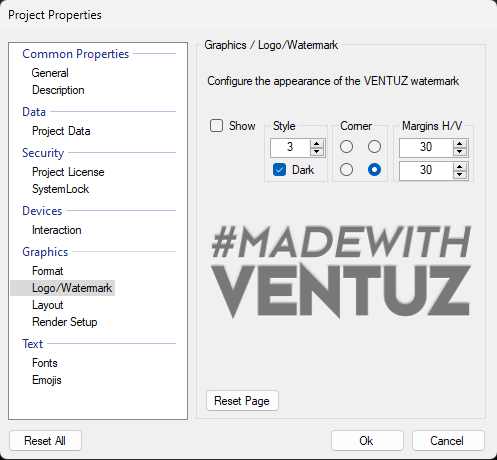

In the Ventuz Community Runtime the engine will render a branding watermark at all times. To let this watermark fit into your project's look more easily you can adjust its style. There are several different watermark images to choose from - each of them are available in transparent white and transparent black. Additionally you can define choose the location of the watermark by adjusting the corner and a margin from the screen's edge.
Note that the size as well as the position of the watermark are all relative to the screen. The Margin is given in Pixels for a target resolution of 4k (3840x2160 Pixels).
