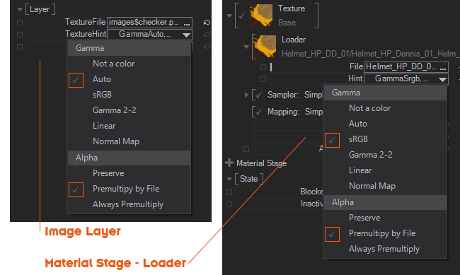

With the TextureHint you can specify how to treat color and alpha values for the loaded Image, Texture or Video.
The TextureHint drop down menu has the following options available for the Gamma part: The default setting is Auto except for the Material Editor Stages - here the settings depend on the type of the selected Material Stage.
The Not a Color for example is used mostly for Roughness and Specularity Material Stages since the Texture is used without any gamma conversion and these Textures are usually Grayscale. Textures loaded with this option will not be touched or converted internally into any other colorspace which is important when using the HDR-Render Mode.
sRGB defines to use the Texture in the sRGB colorspace, which is the standard for Images, Videos and most Textures.
Gamma2_2 loads the Texture in Gamma 2.2 which is most times needed when using Cubemaps/Environment maps in HDR. Linear loads the Texture in Gamma 1.0.
Normal Map uses a special internal routine to blend the colors between the different MipMap stages to result in normalised Normal Vectors. This makes it possible to have Crisp and correct MipMaps.
At the bottom of the TextureHint drop down menu you find the options for the Alpha. The default is Premultiply by File which detects if a premultiplication is needed. Preserve will never premultiply and keep the alpha as-is. While Always will force a premultiplication.

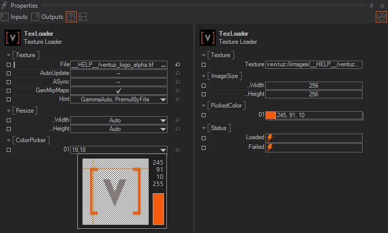

Color Picker
One or more ColorPicker items can be added to the TextureLoader via the Custom Model. Adding a ColorPicker item adds a new input property to specifiy x and y position of the color to be picked on the texture. A new output property provides the color of the selected pixel.
Note that the texture in the picker is scaled down to 128x128 pixels.
