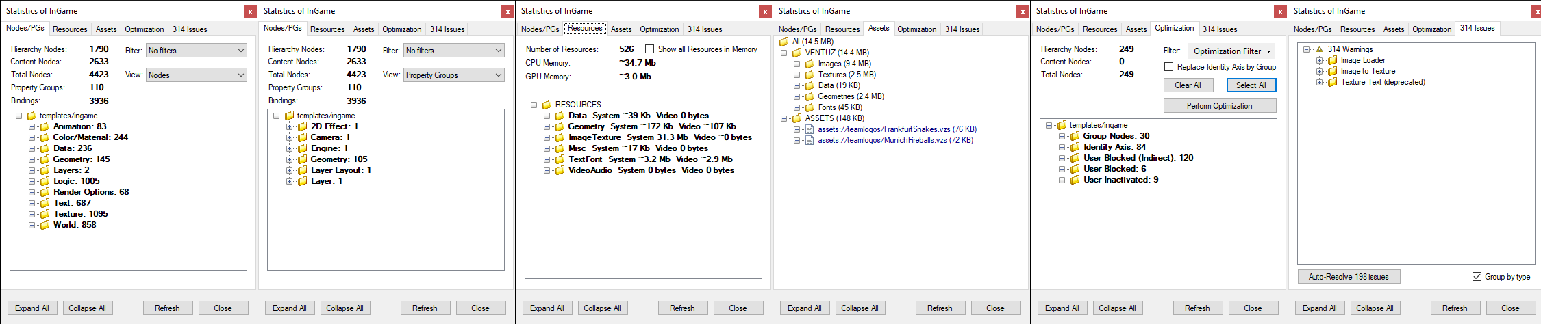

The Scene Statistics dialogue provides information about the nodes and their occurrence that have been used in the scene. It shows which scene components and resources use how much memory space. Additionally all assets that are used in the open Ventuz scenes are listed.
The Statistics dialogue is separated into five parts.

Nodes/PGs
The Nodes/PGs tab gives an overview of the nodes and property groups used in the currently open scene. Below the summery all used nodes are listed according to their Toolbox category. The number behind the category folder is the total number of nodes from this category in the scene. If one expands the folder, all used node types and their occurrence are listed. It is possible to double-click on an entry and the Hierarchy and Content Editors will navigate to the according node in the scene tree.
The View can be switched to see not only the Nodes but the used Property Groups.
Additional filters can be applied to list e.g. deprecated nodes, see the following list for more. Use the Mark filtered selection in Editors flag to highlight the filtered nodes in the Hierarchy and Content Editors.

Resources
The Resources tab shows the memory usage of all scene resources. If the Show all Resources in Memory option is enabled, all resources of all loaded scenes will be listed; otherwise only those of the active scene. The resources are assigned to different categories/folders:

Assets
The Assets tab lists all assets that are currently loaded into memory. Every asset entry lists all those nodes which reference this asset. The assets are sorted according to their data pools in the Project folder. Here it is possible to replace certain assets for the whole scene or single nodes or to perform an automatic search and replacement for missing assets. Just press the on a tree node to get a context menu with the possible options.
Optimization
In the Optimization tab it is possible to detect and remove unnecessary nodes. Optimizing a scene can improve its performance and reduces size. It makes sense to check the scene for unnecessary nodes especially if one works with lot of copies of the same (Hierarchy) Container.
The Optimization process is destructive and cannot be undone! The only possibility to go back to pre-optimized state is by saving the scene before!
Following optimization filters are available:

Issues
The Issues tab lists all nodes that are causing issues. Scenes from older Ventuz versions can contain nodes that do either not work at all any more, cause errors in the rendering or only function in a limited fashion.
