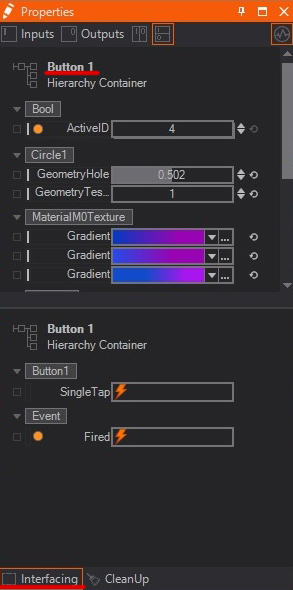

To use Containers effectively you should know what the Interfacing mode does and how to use it.
Interfaces
When working extensively with Containers, inevitably in-use Containers will require modification. Whether it is a bug that needs to be fixed or additional functionality added, the change is done in one instance and manually has to be transferred to all other instances. The usual method to do this is to remove all other instances, duplicate the modified version and manually reconstruct all pre-existing bindings.
Interfaces are an extension of the Container idea to address the above, and other, problems. They define which properties a Container has to provide in order to be used in a certain part of the scene. A Container Interface keeps its properties (and therefore its bindings as well) intact even when the encapsulated nodes are removed. When the content of a container is replaced, new exposes can fulfill the interface properties.
This is especially handy if you are building content that is mostly the same. Like buttons for a user interface or lower thirds with animations. Here is a short explanation on how to update Interfacing Containers and what is important while doing so. After creating your first container  click on the Interfacing button on the bottom of the Property Editor.
Notice the name of the container, too. This has a number at the end so later the number will go up with each copy that we create.
Now you can just copy and paste the container with CTRL + C and CTRL +  V or by holding down CTRL and  click and hold while draging it to the place where it should be copied inside the Hierachy Editor. If you now change anything in one Container you can update the other ones with it so they all have the same settings. To do this  click and hold the left mouse button from the changed Container and drag it over to the one you want to update. While hovering over this Container  click it to update it. You can continue holding the left mouse button while right clicking on all the other Containers that should be updated.

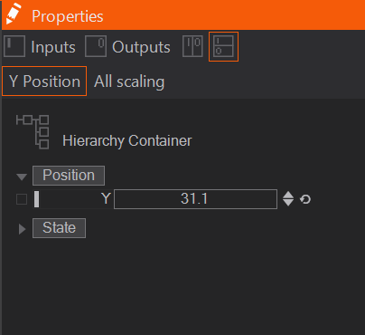

Usually you dont want to have X numbers of Containers with exactly the same values in their properties, e.g. to place them at different locations. So to keep those values unique, you need to Expose all properties that should not be changed while updating them - exposing a property makes it a part of the Container's interface, and - as discussed earlier - the interface defines which properties are coming from outside the Container. Lets say the content inside the Containers should all have a different X position value. Then you dont need to expose it on every single container and update them. You can rather just expose the X position value on one Container and then update every other Container. You will notice that they will still sit on the same position, but if you now change the X value for every updated Container individually the values and position will stay the same the next time you update them. This can be done with every Property inside a Interfacing Container.
More importantly though, you can bind interface properties and these bindings will persist between

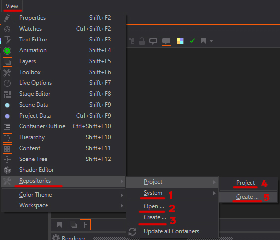

The Repository lets you store either individual nodes or subtrees of nodes by dragging them into the Repository window (for Content Nodes, press and hold CTRL while dragging  them to the Repository). If that window is not open for you, open it by going in the View menu and click on Repository followed by what you want to open.
  • 1.Will create a system wide Repository which can be accessed via the default Ventuz 6 documents folder or with a custom folder from any project on this machine.
  • 2.Open up a repository from a folder.
  • 3.Create a new Repository saved to a custom folder.
  • 4.Open the projects default Repository.
  • 5.Create a new Repository inside the project folder structure.

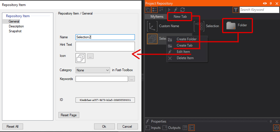

Now you are able to store individual nodes or whole subtrees, give them custom names and icons in there. Furthermore you can access more options for organizing purposes by  clicking on a saved node. Here it is possible to create a new folder or a new tab. As well as editing or deleting the selected node.
When using a custom icon it is advised to not use images larger then 128x128 since this could potentially increase the loading time of the project, while larger images will not have more visible detail due to the icon size inside Ventuz.
When using Interfacing Containers from the Repository they will keep a link to the repository item and you can easily update all referenced Interfacing Containers in your open scenes with the Refresh entry in the context menu of the Repository Item.

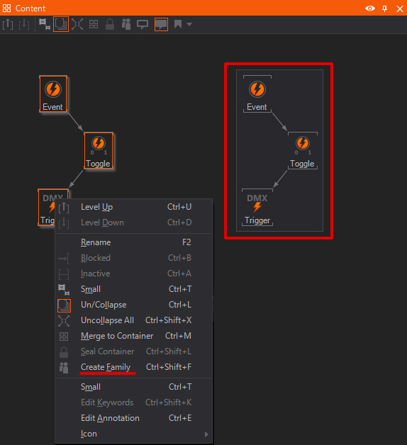

Node Families

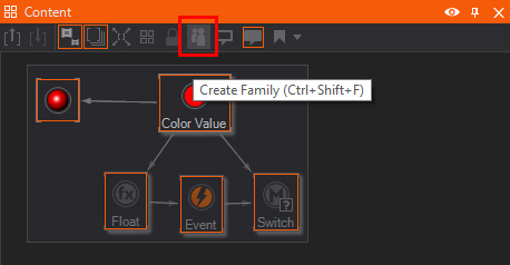

Node Families are a way to group up Nodes inside the Content Editor by marking the nodes needed and holding the button till a menu pops up or use either the shortcut ctrl +  shift +  f or click  the Create Familiy icon in the top bar of the content editor:
These nodes are now in a family and can be moved together by dragging the nodes around by clicking in the empty space of the family. Paired with an Annotation this can help remembering what a certain logic does and is crucial when working in a team.

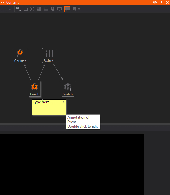

Annotations

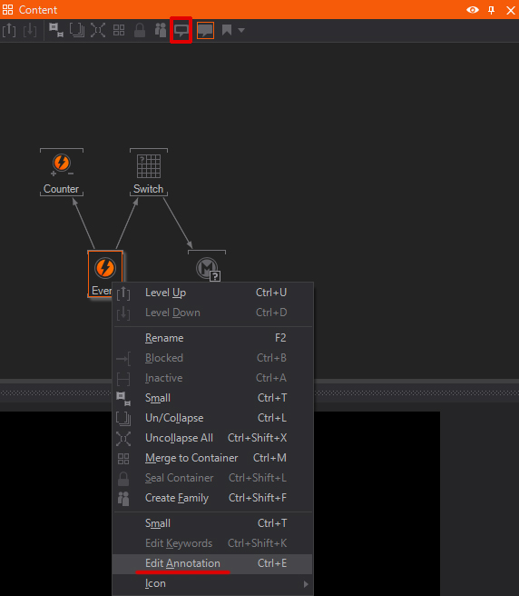

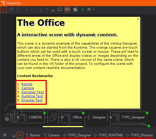

Another great way of organizing and documenting a project are Annotations. With these you can write notes into your project to document what a certain node or a group of nodes does. To add an Annotation just hold the mouse button on the node that should be Annotated and hit "Edit Annotation". Or use the button on the top of the Content Editor / Hierarchy Editor. To disable all Annotations hit the button right beside it.
It is also possible to add an Annotation to the inside of any container or the scene, this is only possible inside the Hierarchy Editor, just  click and hold in an empty space and the menu comes up or use the annotation button on top of the Hierarchy Editor. Since Layers are also Containers you can do this at the root of a 3D Layer.
Double click inside an Annotation to edit it. Use the HTML syntax to format your text. Here is a good page to learn more about the text fundamentals ​HTML Fundamentals
With the help of Bookmarks you are able to build whole navigation structures inside the documentation to easily navigate inside a more complex scene.

Bookmarks
Bookmarks mark certain points inside your node structure inside the Hierarchy or Content Editor, so you can instantly jump to those points without the need of searching trough the whole scene. This is very helpful in scenes that are bigger and more complex. To add a bookmark click on the button on top of the Hierarchy or Content Editor. Bookmarks appear at the bottom of the Hierarchy Editor and can be  clicked to navigate to that bookmark.
The Bookmarks can be individually further edited by  clicking them.

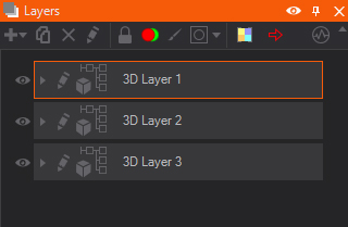

One more thing to further organize and document your scene is the feature to color Layers or Hierarchy Nodes. The button for this can be found on the Layer or Hierarchy Editors.
Note that this feature is only active when a hierarchy node or a layer is selected.

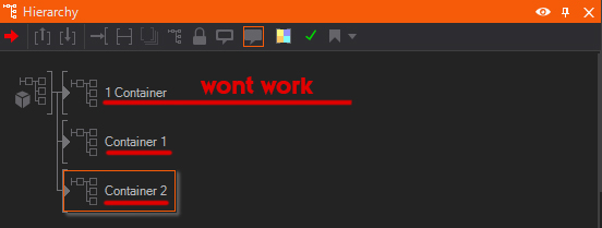

Container:
  • Use numbers at the end of the name to let Ventuz count upwards for every copy made.
Layer:

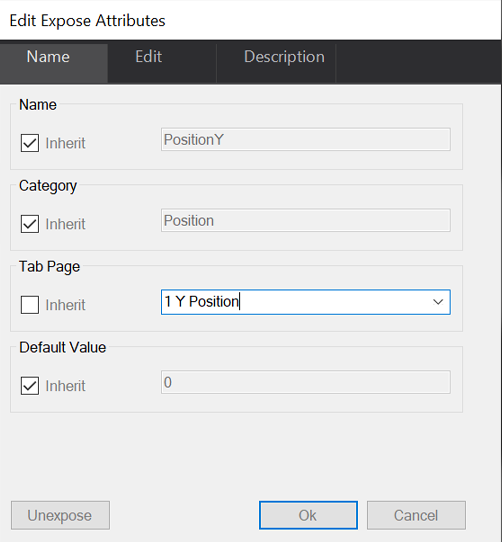

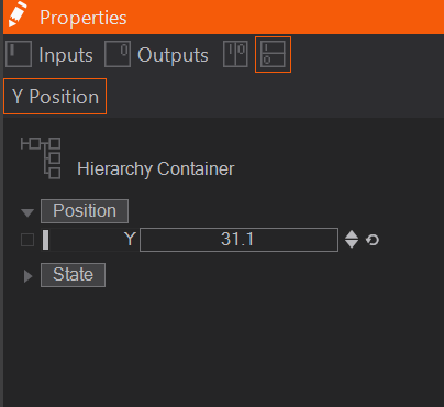

Property Tabs:
  • It is possible to use hidden number sorting when working with Property Tabs. By using a leading number in the name of the tab you can give it a position, so the alphabetical order is ignored.
This number will keep the Property Tab up front. Even if we add another tab that is starting with an A for example.
