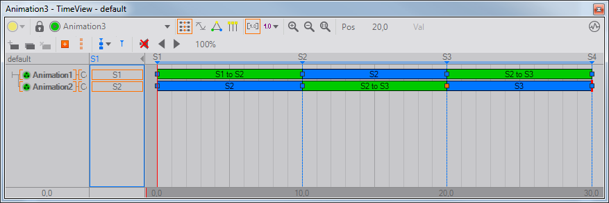

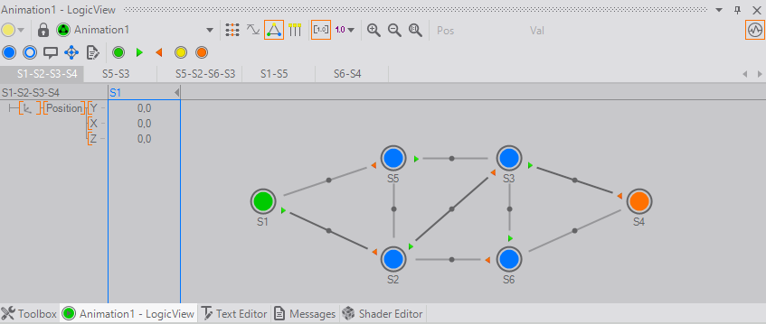

An animation can have more than one timeline, respectively the timeline can be split in multiple parts. An additional timeline is called Slice. By default, an animation has one slice. Especially when working with the State Logic, the whole animation can not be represented on a single timeline. Additional slices appear as tabs in the Time View, Diagramm View and Logic View. Slices can be created, cloned and deleted manually with the buttons in the editors menu bar.
When cloning a slice that contains State Markers the Logic View gets updated drawing new connections depicted by the slice.
If a slice gets deleted the associated connections in Logic View are deleted too.
The slice name is created by default based on the state connections represented on the according slice. The default name can be changed but needs to be unique within all slices inside a single Keyframe Animation Node.
In the Logic View connection represented by the selected slice is highlighted.
To rename a slice, double-click on the slice name on top of the animation channels tree on the left side.

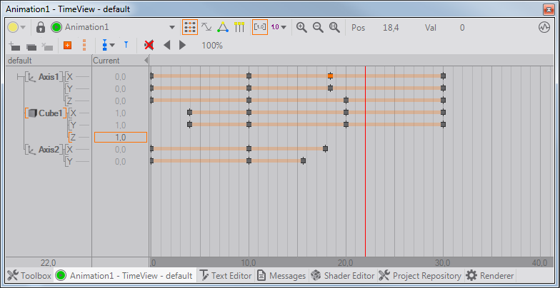

The Time View contains three areas: The left row contains a tree hierarchy of Animation Channels, one channel for each property that is animated by this Keyframe Animation node.
To animate a property, left-drag it from the Properties Editor to the Animation Editor or CTRL + left-click the property name. To create an additional Animation, drag a Keyframe Animation node from the Toolbox to the Content Editor.
The channel list is used to select the active channels that operations like keyframe insertion operate on. To select a channel, click on the channel name and its background will be shaded red. To select multiple channels, press and hold SHIFT while selecting channels. Channels and groups can be rearranged via drag and drop.
The right area shows the timeline for the animation and where the keyframes for each property are set. By clicking into this area, the current time (represented by a red vertical line) can be changed and as long as the left button remains pressed, the animated property will have the value defined at that point in time of the animation instead of the following the global time of the animation. By dragging left and right
, the user can scrub through the animation. The current value at the time, the red line is set to, is shown in the column between the tree hierarchy and the timeline.
Initially, a property has no keyframes. To define a new one, set the current time (red line) to a point in time and then press the Add Keyframes button. Next, while staying at the same point in time, enter a value by double-click on the current column. Without a keyframe, the user can enter a current value but it will not be saved. Keyframes can be removed by clicking on the keyframe and then pressing Delete on the keyboard.
Adding of keyframes is only done for the selected property channels. If nothing happens when pressing the add keyframe button, make sure something has been selected by left-clicking in the tree structure in the left column of the Animation Editor to select one or more channels.
When clicking on a keyframe, the Properties Editor will show additional information about the keyframe. Those will be discussed once the Diagram View section has been introduced.
Multiple keyframes can be selected by either SHIFT+ on individual keyframes or by SHIFT+
outside any keyframe and dragging to start a rectangle selection. Selecting multiple keyframes will draw range borders in the timeline from the very first to the very last selected keyframe. These range borders can be used to scale all selected keyframes. Move the mouse cursor over the range borders until the scale handle is displayed and left-click and drag the mouse to scale in any direction.

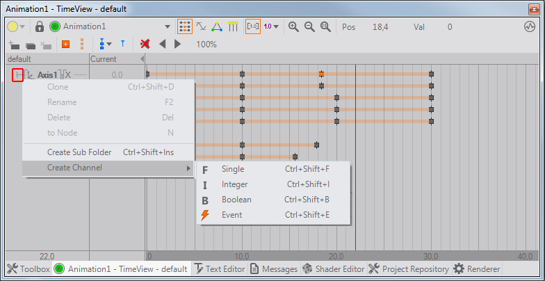

When dragging a property into the Animation Editor, a new Animation Channel is created for that property. A group with the node name is added, beneath that a group with the property category name and finally the entry with the property name. It is important to keep in mind that the name of all those items or the structure can be completely changed by the user. It is just a logical grouping that has no effects on the values generated.
New channels can be created by -hold on the root of the channel tree (the small T junction in the top left corner).
A created channel is not bound to a node automatically. Drag a matching property on the channel to assign it to a node. Check the context menu of a channel to see if the channel is bound to a node and/or to which.
Animation channels can be cloned to simply duplicate or to easily create a channel with slight variations. Either click on the desired channel and select clone from the context menu or CTRL + drag
the channel. A cloned channel is not bound to a node automatically. Drag a matching property on the channel to assign it to a node. Check the context menu of a channel to see if the channel is bound to a node and/or to which.

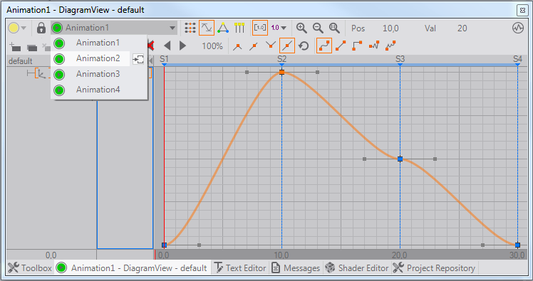

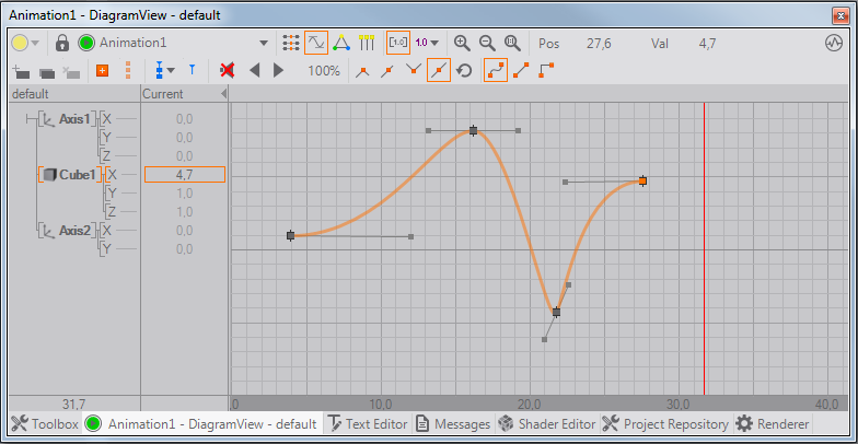

While the Time View is mainly for organizing a large number of keyframes in an efficient way, the Diagram View visualizes the actual change in values over time in the form of function curves.
Time View and Diagram View share much of the same functionality which will not be repeated here. However note that only the curves of selected animation channels are shown in Diagram View.
Keyframes can be added, modified and deleted in the same way as it is done in the Time View. What is unique to the Diagram View is that the interpolation behavior of the curve between the keyframes can be adjusted.
There are three ways the values between two keyframes can be interpolated. This type can be set for each segment of the curve individually by selecting the keyframe at the beginning of the segment and then choosing the appropriate interpolation type.

The two special interpolation types Elastic and Bounce have additional keyframe parameters that can be adjusted to modify the shape of the easing function. This easing functions are identical to those used in the Easing Nodes. Please refer to the easing documentation for details about the parameters.
When setting a curve segment to smooth interpolation, tangent handles will appear at both sides of the keyframe which can be dragged to influence the curve. Such a keyframe can have one of four locking types that describe the relation between both handles.
Icon | Name | Description |
![]() | Free | Both tangents are completely independent of each other. |
![]() | Direction | Both tangents will be forced to have the same direction but can have different length. |
![]() | Mirror | One tangent will be the mirror image of the other. |
![]() | Fully Locked | Both tangents will have the same length and direction. |

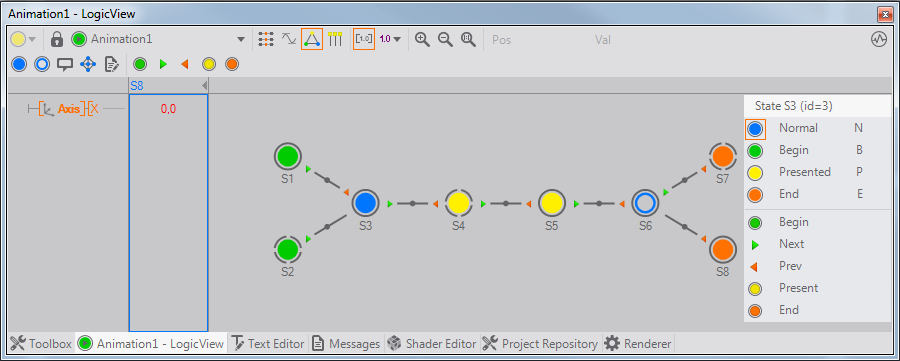

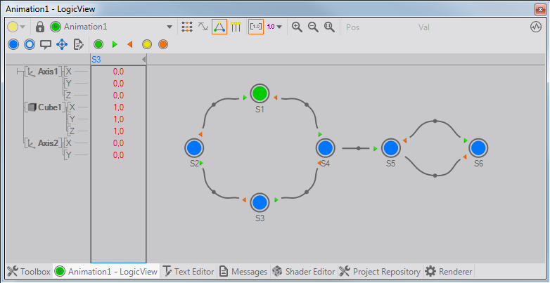

The Logic View is used to define states and the transitions between them. For a discussion on the types of States and the State Engine in general, please refer to Animation and State Engine.
States are represented as circles in Logic View and as timeline markers in Time View and Diagram View. Filled circles are used for Hard States and rings for Soft States. Each state has exactly one representation in Logic View regardless of how many slices are associated with it.
New Hard or Soft States can be created by using the respective buttons in either the Logic View or one of the other views. A Hard States keyframe values will be set to the current value in the animation channels. To delete a state, select it by left-clicking on the circle and then DELETE. If a Hard State is selected, a blue box will be drawn around the current values column indicating that any change in this column will be stored in the respective keyframe. Finally, double-clicking on the state name allows the user to rename the state.
A State can be assigned one of a number of Types by selecting the State and changing the type property in the Property Editor or on the state to open the context menue.
Type | Icon | Description |
Normal | ![]() | This is the default type, no special semantics are associated with this state. Press N to turn the selected state into a Normal state. |
Begin | ![]() | Triggers the BeginReached event of the Keyframe Animation Node. |
Begin Default | ![]() | Same as Begin but this state is jumped to when the user triggers the Begin method of the Keyframe Animation Node. There is always exactly one default begin state in a State Logic. Press B to mark the selected state as BeginDefault state. If another state was the BeginDefault it turns into a Begin state. |
End | ![]() | Triggers the EndReached event of the Keyframe Animation Node. |
End Default | ![]() | Same as End but this state is jumped to when the user triggers the End method of the Keyframe Animation Node. Press E to mark the selected state as EndDefault state. If another state was the EndDefault it turns into a Begin state. |
Present | ![]() | A present state marks a state as being self-sufficient or semantically relevant to the audience. In most situations, they are treated the same as normal states but a state has to be a Present state to act as a Templates. |
Present Default | ![]() | Special State Type used in the context of the Template Engine and marks a Template. Press P to mark the selected state as the Present Default state. |

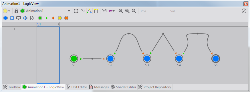

Connections between States are the visual representations of parts of an animation timeline. These connections are automatically created if two or more States are added in Time View or Diagram View.
Create Connections
To manually create a connection between two States, click on a State and drag
on top of another state (or the same state). During the drag&drop operation, a black arrow indicates the direction of the connection.
Creating a State connection between two States in Logic View will automatically create an associated keyframe animation called a Slice. To access the associated animation for a connection, double-click on the connection to switch to either the Time or Diagram View (whichever was used last).
When a new connection is created, Ventuz tries to add the new animation to a previous one instead of creating a new Slice. This is possible if an older Slice ends with the State the new connection starts from. While this seems inconsistent to the advanced user, it helps present a uniform timeline for linear State Logics and thus ease the transition for new users.

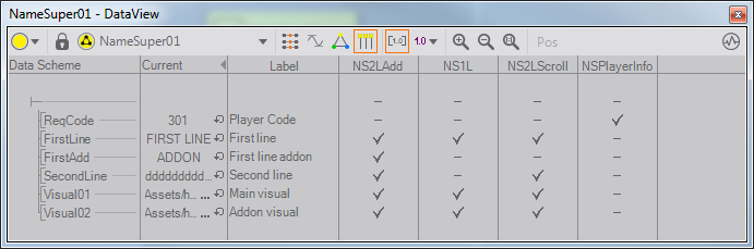

The Data View works in conjunction with the Logic View to define properties of Templates. By -hold on the root (the small T junction in the top left corner), new data channels can be created similar to the Project Data and Scene Data editors. Each present state in the state logic is listed as a column. By setting a flag in the right column/row, a data channel is associated with a state. Together this information defines what properties a template has. For more details, see Templates.

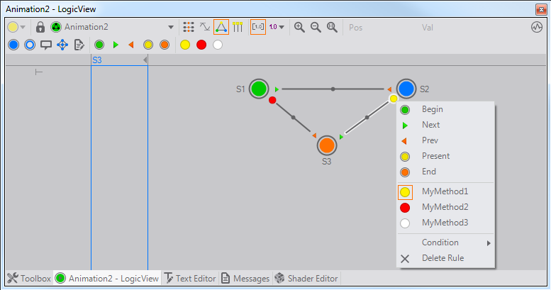

The Next/Prev methods can be used to steer the direction in which the State Machine should continue. Each State can have one connection marked as the direction to follow when the State Machine is at that State and the Keyframe Animation Nodes Next method is triggered. The same is true for the Prev method. If done correctly, the user does not have to know anything about the individual states or even how many exist. He just decides if he wants to go forward or backward in his presentation.
When a connection is made between two States and a next/prev connection has not been assigned, they will be automatically. To explicitly assign next or prev, select the Keyframe Animation node in the Content Editor and drag the method on to the start/end of the State Connection. To revoke the assignment, select the State Connection and reset the Begin or End rule in the Property Editor. Another way of assigning methods to connections is to right-click on the beginning or the end of a connection and choose an Input Method from the context menu. Be careful to click on the connections end and not on the State!
As Next/Prev are just default Input Methods that are useful in many situations, the author can even add new methods to the State Logic by using the Custom Model on the Keyframe Animation node. Added Input Methods now appear in the Property Editor of the KeyframeAnimation Node and can be triggered like any method. You can assign these methods to connections as stated above. Now if the Input Method is triggered the State Engine follows the according connection.
Simple Example:
In this example the Keyframe Animation Node has four new Input Methods (toS1, toS2...), created by the Custom Model. These methods has been assigned to the connections in a way that no matter what state the State Engine is on, triggering the method follows the connection to the according state. For example, if on State S2 triggering toS1 follows the connection between S2 and S1, whereas on State S3 triggering toS1 follows the connection between S3 and S1.

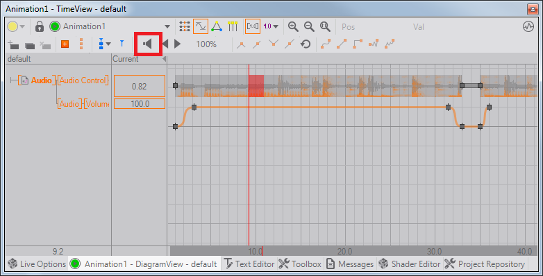

Similar to nested animations, an animation can also take control of audio/video content by binding to the Control Input Property of a Movie Clip, Sound, Audio Clip or Sound Source 3D node. Instead of triggering a node's play/stop method (thus letting the node run independently of an animation), the exact playback is controlled by the animation. When the animation is paused, the audio/video will pause and when the operator jumps to a specific point in the animation, the audio/video will also continue from that point in time. This allows the user to create animations that are perfectly synchronized to the audio or video content and to easily review them.
Upon binding the Control property to an animation, a new animation channel is created and certain now irrelevant properties will be hidden on the node itself. The channel itself is empty as there is no keyframe yet to synchronize the audio/video playback. By selecting the channel and inserting a keyframe, a wave form of the clip's audio will be rendered directly on to the animation channel. Overlayed on top of the wave form is an frequency analysis, rendered in orange. For processed/mastered music like modern pop/rock songs or electronic music, a wave form by itself is pretty non-descriptive and the frequency analysis makes it easier to spot where the beat is or the mood of the music changes.
If a movie node's Enabled property is turned of to clear the movie from memory, no waveform will be rendered inside the Animation Editor.
Keyframes for audio/video content have one of two functions which can be toggled by double-clicking on the keyframe:
It is not possible to pause and resume audio/video content using keyframes. Instead a second play-keyframe with an appropriate offset value has to be used. Also playback is unavailable when an animation is running in reverse direction.
In contrast to ordinary video playing software, Ventuz aligns audio to the graphics output instead of the other way round. While a video player might drop frames to be always perfect in sync with the audio content, Ventuz performs on-the-fly re-sampling of the audio content to align playback to the video outputs. However, the drift between audio/video is kept below 1% and therefore any changes should barely be audible at all to the audience. If for some reason the drift lies beyond 1%, Ventuz will seek/jump in the audio material to re-align. If perfect syncronization is required, a synchronized audio hardware board should be used.
To monitor audio content at the current position of time within the animation, enable the Speaker tool button (marked by a red rectangle in the screenshot above). The red area next to the vertical line representing the current time is the area that is looped for monitoring. One great advantage of having this direct integration of audio/video inside an animation's timeline is that a user can scrub through the timeline and quickly find a position in the middle of a clip where he wants to continue his work. The speed of seeking within a clip is mainly dependent on the type, format and encoding of the content. For example, due to the long seeking times, monitoring online clips is not recommended!
If the buffering mode of a Movie Clip node is not on Normal, no audio will be available.
One very interesting feature worth mentioning here is the use of soft states within audio/video content. Since they are not related to key frames, they can be used as jump points or bookmarks to mark points of interest within a clip. This is often used for rehearsals of long presentations to jump to a specific section of the animation.
