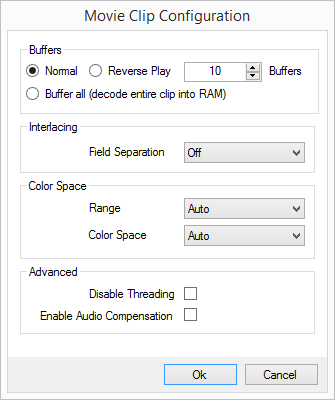

The configure button at the bottom of the property editor brings up the movie clip configuration dialog.
Here the way video frames are buffered is configured:
Audio is only available in Normal mode.
In some situations, the node may need to allocate more buffers than specified in the configuration. The amount of memory used for video and audio buffering can be monitored with the MemoryMB output property.
Only use this when playing interlaced movies to interlaced SDI outputs
This will guarantee that the fields of the movie will end up in the right fields of the SDI output. In any other scenario than interlaced playback to interlaced SDI, this will mess up the replay.
Usually Ventuz will automatically detect color space and range. But some codecs give false information, and some clips are badly encoded. These options allow to override the automatically detected. When using these options, be careful not to do more harm than good! These options do not apply to RGB encoded clips or images.
Color Space is one of the YUV color spaces. The difference between these is largest for saturated colors, so when in doubt use clips with color bars to check. On normal material the difference is often hard to see.
Name | Description |
auto | use automatic detection (recommended) |
BT601 | used by NTSC & PAL |
BT709 | used by modern HD standards |
SMPTE240M | interim specification, replaced by BT709 to which it is similar |
FCC | FCC version of NTSC, basically BT601 rounded to two decimals |
Many codecs encode YUV in a limited Color Range from 16 to 235 (Y) or 240 (UV), emulating the footroom and headroom of an analog signal. As color space, this is usually detected automatically. If this is wrongly detected, a significant change in contrast and brightness is seen, and the Color Range option can be used to override.
Disable Threading
For most codecs, each MovieClip node will create as many threads as there are cores available. If many clips are played back, this is counterproductive as these threads get in each others way. Also they may steal time from the Ventuz main thread, causing stutter.
Enable Audio Compensation
Often the audio hardware is not perfectly in sync with the video hardware. In such cases, the audio must be slowed down or sped up a little to compensate when playing back long video clips. This is called Audio Compensation and is explained in detail at the Sound Nodes.
