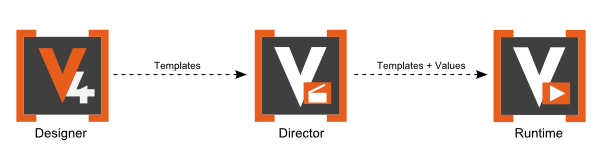

Director is a control application in that it by itself cannot create any 3D output. Instead, it manages one or multiple Ventuz Presentation Runtimes and instructs them what to do. The presentation runtimes interpret those commands, load the required Ventuz scenes and assets, play animations and do everything else that is required to produce the appropriate 3D output. Therefore setting up the Ventuz environment and machine communication is of great importance.

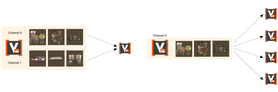

Channels
Director is build around the concept of channels, separate feeds of content. Much like an audio application can have separate channels for vocals, guitars and drums which are then mixed to produce a single song, Director can provide multiple channels to manage separate content within a single show. A channel allows multiple machines to connect to the same stream of templates or to have multiple layers of content on the same machine. For example, a single operator may drive content of a game show on a big wall of displays in one channel while also controlling separate displays for the audience that contain total different information in another channel.
A typical Director show consists of a single channel. This is sufficient for the majority of applications and the reason why most of this documentation won't explicitly refer to multiple channels. All concepts of Director that are introduced in the following chapters extend to working with multiple channels and it is therefore left to the later chapters such as Topology or Channel Configuration to discuss the more advanced scenarios.

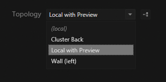

Topology
Which machines are actually attached to a channel is specified in the active Topology. A topology can be created, modified and saved via the Topology Editor which is usually done by the IT department managing the machines way before any show is run on a given setup. The Ventuz Director operator simply selects the correct topology from the empty workbench and launches his show.
In addition to the topologies stored in the local machine's configuration folder, the list of available topologies always contains a simply default topology for the local machine called (local). This configuration is ideal for new users that want to learn Director, working with remote machines is discussed in a dedicated chapter.

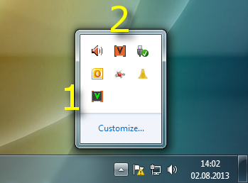

The user interface for the VMS is pretty minimal. Byright mouse button clicking on the VMS icon in the Windows system tray, the operator can specify project folders that should be made available via the VMS and trigger a re-scan of those folders. When Director tells a VMS to start the Ventuz Runtime, the VMS searches those folders for the required local copy of the project.
If Director reports an error as it failed to find a project, make sure your project is located in a folder (or sub-folder of) that is part of the VMS configuration list and trigger a manual scan of projects.
  1. VMS with a valid connection to a Ventuz Runtime (green status)
  2. A running Ventuz Runtime

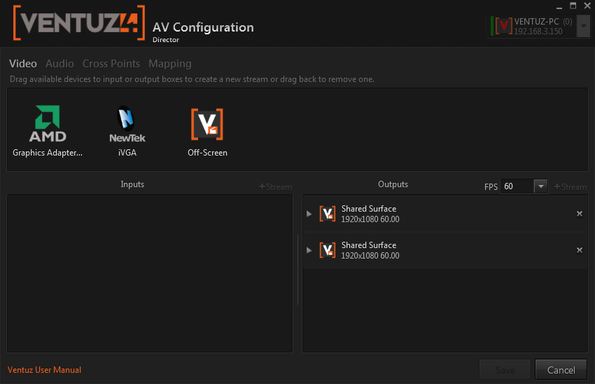

Pipes
Each channel connects to two so-called pipes provided by the Ventuz Runtime: Program and Preview. Each pipe has an independent output and a template engine that controls the content shown on that pipe. Both can be configured inside the Audio/Video section of the Ventuz Machine Configuration Tool. The Program Pipe usually shows the final result the audience will see. The Preview Pipe is used to provide visual feedback to the operator while he is editing a template.
The output of a pipe can be one of three types:
For example, an operator sitting in a TV broadcast station might have the program pipe configured to use an SDI output which goes to the mixing desk. The preview will be an off-screen surface so the operator sees what he is editing or another SDI board if other people inside the broadcasting room are interested in that as well.
The default of having two off-screen surfaces is great for learning Director since the user has both a working program and preview window inside Director. However, a production configuration would at least assign the program pipe to either SDI or graphics adapter since otherwise no one except the operator sees the output signal!
