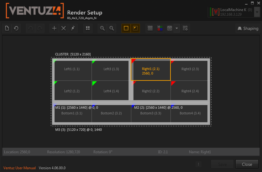

The Render Setup Editor is part of the Ventuz Configuration and is used to create an XML configuration for complex display walls. The content for such display walls may come from a single or from multiple Ventuz machines.
Generally speaking the Render Setup Editor is used to solve following problem: Display Ventuz content correctly on an arbitrary complex display wall built up of N displays connected to M machines.
The editor basically consists of three parts: the Toolbar on top with some edit commands, the Display Editor in the center to arrange machines and displays and the Statusbar at the bottom with some additional information for the selected object.
The display wall shown in the example consists of 4x3 displays and has a total resolution of 5120 x 2160 pixels. It is built from 3 machines: two machines have a 2x2 display setup, the third machine has a 4x1 display setup.
The dashed frame marks the visual border of the whole Cluster or Render Setup respectively. On top of this frame the visual resolution of the Cluster is displayed. (The Cluster always has the default name CLUSTER.)
The broad frame marks the visual border of one machine. Below this border the machine name, its visual resolution and its position is displayed (more details below)! Each display has its name written in the center (with its ID in brackets); if a display is selected its coordinates are shown too. The name and the assigned color can be changed by editing the properties (CTRL + SHIFT + E or Edit properties in the toolbar). If a machine is selected, its ID can be changed to a new free value.

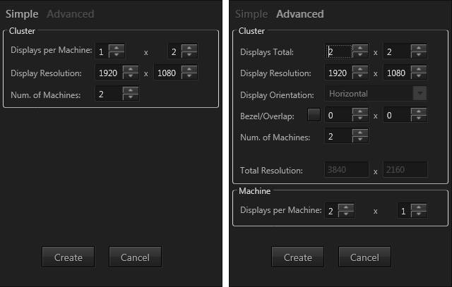

To create a new Render Setup launch the New Setup dialog. This can be done by pressing CTRL + N or clicking on the first button in the Toolbar. This will bring up the following dialog:
The New Setup dialog consists of two tabs: Simple and Advanced.
In Simple mode one has to specify the number of displays per machine, their arrangement and the resolution per display. Finally the number of machines has to be given. Clicking Create will arrange the machines from left to right in the Display Editor.
In Advanced mode first of all one specifies the display arrangement for the whole Cluster and the resolution per display. In Advanced mode it is possible to specify a Bezel or Overlap area for displays with frames or projectors. The unit of these values is pixels.
In the next step the total display arrangement must be distributed over a certain number of machines.
In the Machine section one has to specify the display arrangement per machine if there are multiple possibilities for the whole cluster with N machines.
Example: a cluster of 4x2 displays with 2 machines can be created from 2 machines with 4x1 displays aligned vertically or 2 machines with 2x2 displays aligned horizontally.

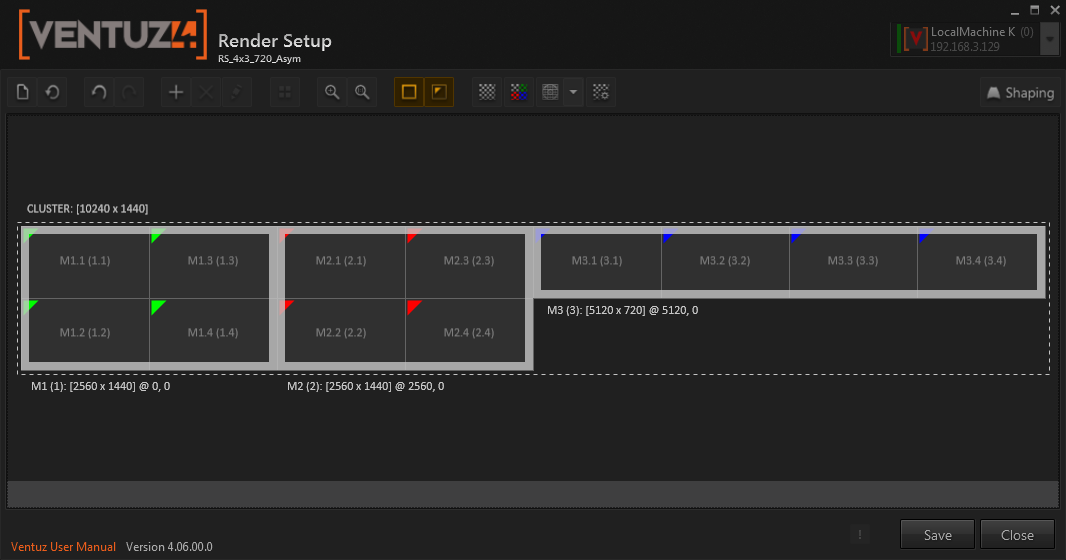

Automatic Render Setup from VMS
There is an additional way to get an initial Render Setup if one creates a new entry in the Ventuz Configuration. The Ventuz Machine Service (VMS) is able to retrieve the display configuration from NVIDIA and AMD graphics cards. It reads the Mosaic or Eyefinity configuration and creates a corresponding display arrangement in the Render Setup editor.
For the example above the initial Render Setup from the VMS will look as follows:
As there is no information about the visual relationship of the machines to each other, they are arranged horizontally from left to right. To achieve the final result you just have to move the 4x1 machine to the bottom of the other two.

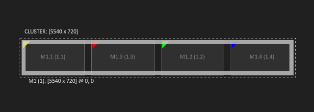

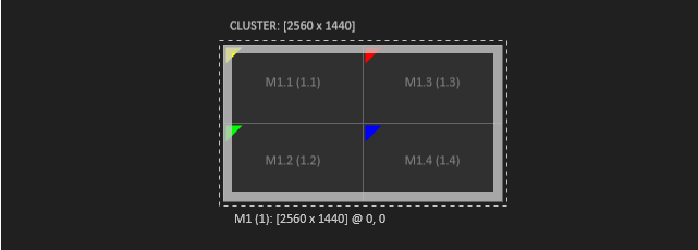

Logical vs. Visual Resolution
In the context of the Render Setup configuration we will talk about Logical and Visual Resolutions.
These terms will be explained here.
The logical resolution of a machine is defined by the Mosaic or Eyefinity configuration of the graphics board. A 2x2 display setup with a resolution of 1280 x 720 px per display has a logical resolution of 2560 x 1440 pixel.
The visual resolution however is defined by final position of the displays in the Render Setup configuration. In the example below the displays are arranged horizontally and have bezel between each other. This leads to the visual resolution of 5420 x 720 pixel.

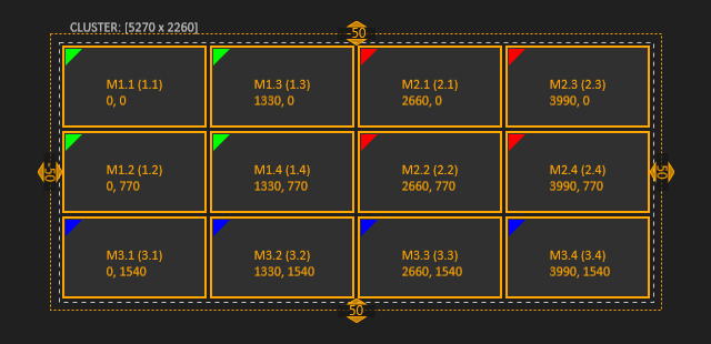

Manipulating a Render Setup
Bezel and Overlap
It is possible to adjust the amount of bezel or overlap between displays interactively in the Display Editor. If multiple displays are selected a Shifting Frame is drawn around the selection. It has a handle on each side to change the bezel/overlap horizontally or vertically.
The values in the handles are related to the last selection and are reseted on a new selection. The display shifting can also be performed with the Arrow keys and a pressed Shift key! Double-clicking on a handle brings up a dialog to set the bezel/overlap values in pixel or in percent of the display size.
