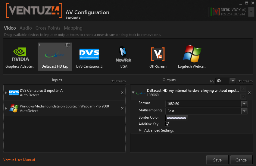

Video Outputs
It is best to specify the frame-rate before creating any output streams. This is done with a drop-down box just above the Outputs window.
The AV Configuration editor displays all supported devices if they are found on your system. The current Licensed Output Options may deny the creation of certain streams! The Ventuz PLE version has no restrictions - all devices can be tested without a purchased license but the output will be branded with a Ventuz logo.
Video output streams are added by dragging a device from into the Outputs window. When doing so, a dialog pops up that allows users to specify some options:
In DirectX Output Mode only one output is supported since Ventuz always runs on a single GPU/Adapter. Combinations between DirectX-Fullscreen and SDI, for example, is not possible!
When configuring multiple inputs and outputs on the same card, arbitrary hardware limitations might reduce your choices.
If the configured output streams are only of type Shared Surface the outputs will be branded with a Ventuz logo if no appropriate License is available.
Video Inputs
Inputs are dragged into the Inputs window just like outputs are dragged into the Outputs window. There is only one mode: input.
Some output modes come with inputs, in this case these inputs automatically appear in the Inputs window. The option for these dual input/output streams are mirrored.
These inputs can be used in Ventuz with the Live Video node.
The video format of inputs can be configured independent from the video format of the outputs. For best results, the frame rate should be the same as the output and all signals should be genlocked together.
Most video boards support Autodetect mode. Should the video mode of an autodetect input switch, the video engine will synchronize on the new signal. If the video board is not in autodetect mode, it will report signal lost until the stream switches back to the configured video format.
A list of available formats can be found here, but not all boards support all formats.

Video Device Information and Options
Each video device has two little buttons when hovering over the device icon.
The little 'i' will open a box with information about the hardware.
The little gear-icon will open a device configuration dialog. The selection of available options depends on the kind of the device and it's capabilities.
Available options are:

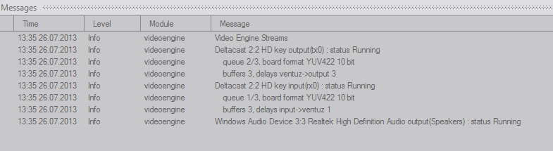

Live Status
By pressing the Log button in the live options the current status of all streams (audio & video) is logged in the message window.
This information is only visible if the message level is set to info or debug. The message level can be set using the right mouse button popup menu.
For each stream, the name and some information is printed:
Status : the state of the stream. The following states are possible
Ready waiting for input signal, ready to go
Presync, Syncing stabilizing stream, synchronizing multiple streams together
Running stream is running normally
Disabled disabled either by the Live Video Node or by the software watchdog.
Bypass bypass relays activated
Error some error condition, see log for details.
Queue : The number of frames queued and the length of the queue. This should be a low number for input streams and a high number for output streams. If Ventuz is temporarily to slow, the input queue fills up and the output queue dries out. If Ventuz recovers in time and renders fast enough, input queues will slowly be emptied and output queues get filled, no frame will get duplicated on the output and no frame will get dropped from the input.
Board Format : When creating the stream, the video engine can be configured to prefer either speed or quality. This effects the selection of a buffer format to be used for sending and receiving data to the video board. What format is actually chosen depends also on the hardware capabilities and if an alpha (key) channel is required.
Name Bits Per Pixel Comment
YUV422 10 bit 21.3 best quality
YUV422 8 bit 16 best speed
YUVK4224 10 bit 32 best quality with alpha
YUVK4224 8 bit 24 best speed with alpha
RGBA 8 bit 32 used as quality option when YUVK4224 10 bit is not available
RGB 8 bit 24 used for some webcams (windows media foundation devices)
YUV422 8 bit with separate alpha 24 used for iVGA, same quality and speed as YUVK4224 8 bit
Generally, RGB(A) is sligtly better then 8 bit YUV(K) but worse and as slow as 10 bit YUV(K).
Buffers : The number of buffers allocated
Delay : The nominal delay of the stream. There are up to 3 kinds of delay:
Input -> Ventuz The delay from input to the Ventuz renderer
Ventuz -> Output The delay from the Ventuz renderer to output
Input -> Output The delay from the input and the output
For instance, in the internal hardware keying without input mode, the delay from input to output is typically zero or one frame, while the delay from ventuz to output is typically 3 to 4 frames. A zero delay is of course impossible, the deltacast keyer for example will shift the signal by around a hundred pixels. This counts as zero frames.

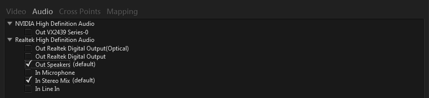

In the Audio section displays all pure audio devices available in the system along with their supported streams (input and/or output). Simply selected the streams you want to use. The default Windows input and output streams are marked with the text (Default).
If portable devices such as USB headsets or USB speakers are used Ventuz will reports errors if the device is turned off or has been disconnected prior start-up of Ventuz. Some devices may change their stream configuration depending on the connected physical cabling. In such a case Ventuz will also report a missed stream on start-up.

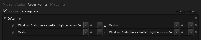

To enable Ventuz to interact with the audio a virtual Ventuz device exists. It provides 8 Record and 8 Playback stereo pairs. If Ventuz needs to receive audio from a stream (e.g. for the FFT Audio Analysis a cable from that stream has to be connected to a Record pair of Ventuz. If Ventuz outputs audio a Playback pair must be connected to the desired output stream or output streams. Any audio related node in Ventuz selects the Record or Playback pair to delegate the audio. The wiring defines how the audio is routed.
By default the Use custom crosspoints check box is unchecked. In that case Ventuz automatically subsequently connects the first stereo pair of all configured audio and video stream to the Ventuz Record Pairs. And all available audio outputs on all audio and video streams to the Ventuz Playback Pairs. All automatic cables are grouped is a single cable-group called Default. If the Use custom crosspoints is checked that cables have to created manually.
Ventuz works like a giant matrix mixer. Any input stereo pair can be mixed to any output stereo pair. In practice usually only a few such cross points are needed. Each line in the configuration represents one cross points. Each cross points consists of an input device with stereo pair and an output device with stereo pair.
Cross Points (or cables) are combined named groups. Inside Ventuz, the volume and stereo panning for each group can be automated by using the Volume Control Node. If many stereo pairs have to be automated in parallel, grouping them and giving the group a descriptive name can avoid confusion.
Please make sure that only one Volume Control Node controls a group at a time. Concurrent controlling would cause unexpected behavior. The rules here are last-in-last-out; the last access to the group in the current frame will set the parameters. If concurrent access happened within one render cycle a silent warning message will be logged.
Each cross point has its own Delay value. Although the default value is 0 it doesn't mean that there's no delay on the audio. The Ventuz Video Engine takes care about the minimum audio delay required to be in-sync with the video output. The user can adjust the delay value in milliseconds, but as long the actual minimum delay is not exceeded no additional delay will apply. The minimum delay depends on the entire structure of configured streams and is currently not displayed to the user.

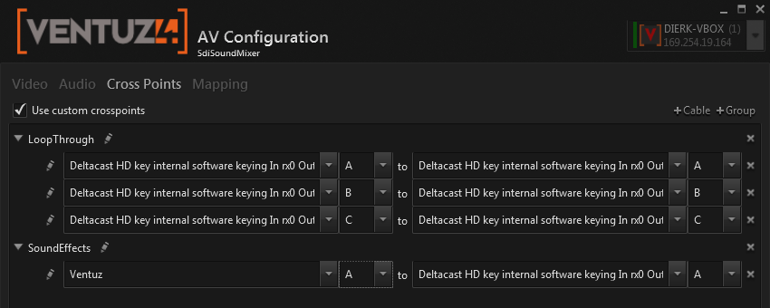

Crosspoints Example: Adding Ventuz to SDI
Let's assume we don't have a hardware keyer (internal or external) that supports audio mixing. In this case, we must use the software keyer. This example shows how to pass through a 5.1 audio signal (not dolby) from SDI in to SDI out and add stereo sound effects from Ventuz.
The AV config for such an situation looks like this:
We have two groups: the first group (LoopThrough) loops the SDI audio input to the SDI audio output. The second one (SoundEffects) adds Ventuz audio in stereo to the SDI output. The volume of each group can be controlled with the Volume Control Node. For instance, one could duck the SDI loop-through before playing sound from Ventuz.
A common mistake is trying to loop SDI output through Ventuz. This will not work. Imagine working with normal audio equipment. Ventuz audio output is like a synthesizer. To add a synthesizer to the mix, one does not loop the signal through the synthesizer, the synthesizer is just connected to the mixer.
The SDI input is like a microphone input, and the Ventuz output is like the output of a synthesizer.
This is confusing. Instead of thinking in terms of inputs and outputs, think in terms of audio sources (left side of the cross-points window) and audio destinations (right side), from the perspective of a matrix mixer. So the Ventuz output is an input (source) to the mixer.

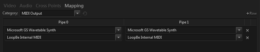

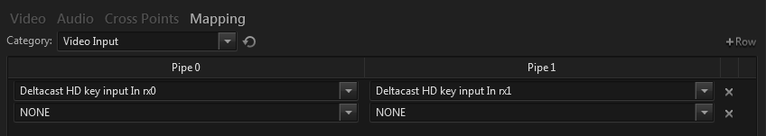

To configure the two output pipes so that each of them has its own live video input as its first device (ordinal 0) use the following mapping. Please note that the second row (ordinal 1) contains a NONE entry for both pipes, because the endless mapping would map ordinal 1 to device 1 if no explicit entry exists for ordinal 1. In this case both pipes would resolve to device 1 (Deltacast HD key input In rx1) on ordinal 1.
Multiple Logical Device Ordinals are allowed to map to the same Physical Device. Simple add a new row and select the physical device again.
Logical Device Ordinal can also map to a NONE device. No device will be address and the node will operate without device (no physical input or output)
