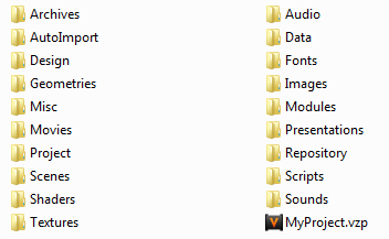

Auto Import
The projects folder structure has a folder named AutoImport. Copying files into that folder will request a running Ventuz Presenter/Runtime to import the scenes and resources of that archive into the project structure. The automatic import of VZA archives allows the injection of new or changed scenes into a running presentation in Director Mode.
During automatic import, existing files are overwritten without further notice. Errors during the import process are written to the log file. After a successful automatic import the VZA is deleted to prevent subsequent imports of the same archive file.
A recommended workflow is to share the AutoImport folder in the network. A Ventuz Designer workstation can create new scenes and new resources, export them as VZA archives and copy it to the network share. A running Director will import the new stuff and make it accessible for a control application.
