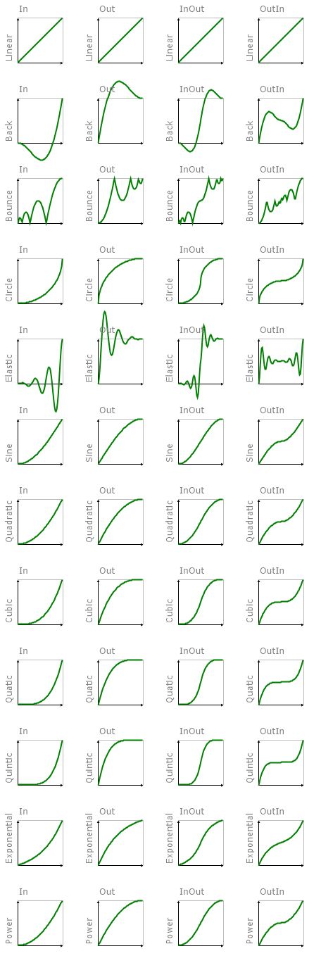

Ease
The Ease node is similar to the other interpolation nodes in that it performs an interpolation by the well known easing functions like Back, Bounce, Elastic, etc. The Function and Mode properties select the easing mode and interpolation type. Some easing functions require additional parameters. If such a function is selected the required parameters show up in the Property Editor while others are hidden.
Overview of all supported easing functions:
Ease Morph
The Ease Morph node blends Begin and Target based on the Morph value by the well known easing functions like Back, Bounce, Elastic, etc. The Function and Mode properties select the easing mode and interpolation type. Some easing functions require additional parameters. If such a function is selected the required parameters show up in the Property Editor while others are hidden.
The supported easing functions are identical to the ones of the Ease Node.
