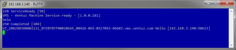

After logging into VMS it displays a welcome message showing the version number of the VMS server.
Typing HELP displays all available commands:
Some simple commands can be executed by command line (telnet). More complex commands (such as uploading new configurations cannot be accomplished by command line, because the data length to be transferred must be known and entered in the command line. It is recommended to perform those tasks programmatically for example with the VMSClient .net class provided in the Remoting4 SDK. The SDK also includes a class VMSDiscovery to locate machine in the network and monitor their states.

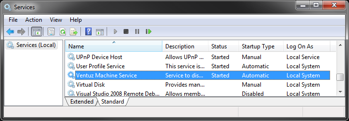

To configure the VMS administration permissions are required. Press the Windows key and enter services.msc into the Search programs and files field. Press ENTER. The Services administration control panel starts up.
Locate Ventuz Machine Service and double click on it to open the service properties.
Disable VMS
To disable the service generally turn the Startup type to Disabled. Press the Stop button. VMS will not be started as service anymore. To re-enable a disabled VMS, just turn the Startup type back to Automatic and press the Start button.

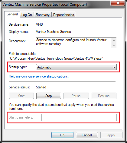

Configure IP Restrictions
To apply any IP restrictions to the service, make sure that the Startup type is in Automatic mode. Stop the service if it is currently running by pressing the Stop button. Now enter the IP restriction command line argument described below into the Start parameters field. Press the Start button to start the service again.

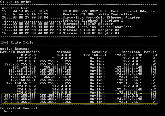

Please note that VMS uses IP Broadcast to send its heartbeat packets (or discover requests). Microsoft Windows routing rules restrict broadcasting packets if your system has multiple connected IP interfaces with the same metric only the first entry in the routing table for one metric value will transfer the broadcasted packets. You can see the current routing tables by entering the following command in the windows command prompt:
route print
In this routing table only the interfaces with the addresses 127.0.0.1 (loopback) and 192.168.3.140 will transfer the VMS broadcast messages. The interfaces with the address 192.168.56.1 won't transfer the broadcast packets.
This Microsoft support page explains how to change the metric of network adapters.

HELO (short for hello) return a message that contains the unique system identifier (SystemID), the version number of the VMS and the IP endpoint of the connected client.
HELO 250 Completed [104] VZ_108290380002111_BFEBFBFF000106A5_00426-065-0527052-86603 Hello [192.168.3.140:50613]
