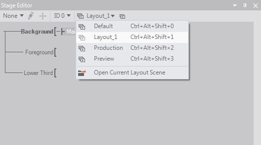

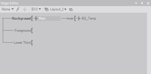

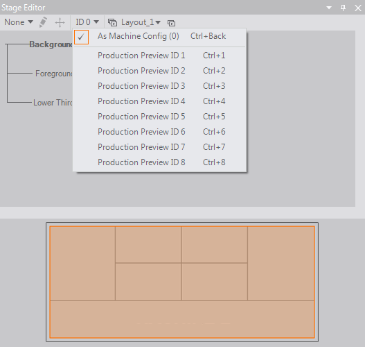

When working with nested scenes and Remoting, one can easily lose an overview of which scene is rendered where. That is why Ventuz provides the Stage Editor (Ctrl-F12):
This editor shows all scenes in memory along with their available ports. Scenes can be loaded by Ventuz Designer, by a Scene Port or by Remoting. The editor uses a tree-like visualization similar to that used in the Hierarchy Editor. Drag&Drop makes it easy to assign scenes to Ports and track assignment changes via Remoting. The scenes currently opened in the Designer as well as the current Layout scene are visually marked in the Stage Editor.
The screen-shot above shows following situation:
Inside the Stage Editor one can switch the Layout to be used by the current project (see below) as well as temporarily change the MachineID for the local machine in order to test cluster setups. The MachineID also influences the Clustermode Preview.
Both features are also accessible via keyboard shortcuts.
The editor itself is quite simple and has no hidden key shortcuts for special operations, only drag & drop and the tool-bar on top!

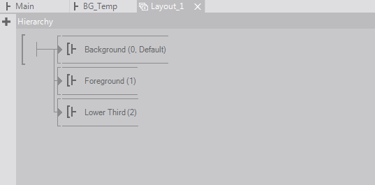

Layouts are usually very simple scenes holding at least one unlocked Scene Port, preferably Port Ordinal 0 (the default port) is not locked. A Layout scene is a normal scene: one can use all nodes, add properties to Project and Scene Data and insert layout related content. The possibilities of Layouts are numerous:
Layout scenes opened in the Designer via Stage Editor are marked with a special icon in the scene tab!

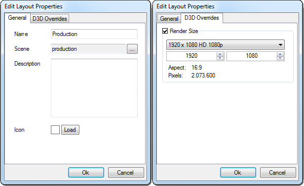

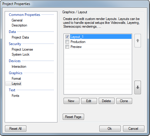

The configuration of Layouts is done in the Project Properties. The Layout section in the Project Properties dialog provides possibilities to create and edit Layouts.
A Layout setup is created by click the New button. In the General tab, a name for the Layout and the actual Layout scene file can be chosen. The fields Description and Icon can be used to help other users who work on the same project.
Every entry in the Layout list has a prepended check-box. The checked Layout is selected as the Runtime Layout which is automatically used if a scene is exported as Presentation (VPR) or the Ventuz Runtime is started in Director mode.
A very important feature of Layouts is the possibility to override the actual rendering and screen settings of the actual Ventuz project. In the D3D Overrides tab, a small check-box on every configuration group can be checked to specify new values for each particular Layout.

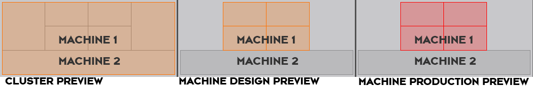

The Clustermode preview shows a preview of the currently active Render Setup.
To change the active Render Setup select one in the drop down menu on the top-left corner or in the Ventuz Configuration Editor.
Three different preview modes are available:
