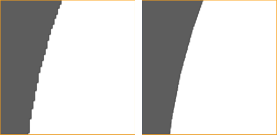

To reduce the amount of alias ("pixelation") when doing any rendering (whether into a texture or onto the screen), graphics cards can render in a higher resolution internally and the re-sample down to the target resolution. This process is called Multisampling, sometimes referred to as anti-aliasing. There are three places the multisampling quality can be specified:
Ventuz defines the following quality settings:
If the whole scene is rendered into a RenderTarget and that texture is simply mapped to the screen via an Overlay Rectangle, multi-sampling should be activated in the RenderTarget and deactivated in the Project Properties. Multi-sampling the rendering to the screen when the Texture is already multi-sampled would only unnecessarily increase memory consumption and decrease render performance because textures (in our case the render target) are not multisampled at all! Only edges of geometries are affected!

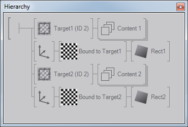

To save graphics card memory and improve performance, the memory allocated by a RenderTarget node can be shared by assigning a common ShareID different than -1 to all RenderTargets that should share a texture. RenderTarget sharing only works if the according RenderTarget nodes match in all parameters (like size and multisampling quality). The ShareID technique allows sharing of render targets across different scenes as long the size and multisampling settings of the shared render targets are equal.
The following example shows two RenderTarget Nodes that share the same memory. Since the output texture of Target1 is used before Target2 is reached in the render order, Target2 can clear and re-use the same memory without any visual difference to using two separate RenderTargets. To avoid clearing the content of a shared render target use a Viewport node as the first node behind the render target and disable all clear options of it.

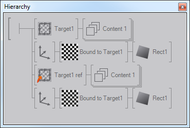

An second way of sharing render target is via the Render Target Reference node. This node can only be used within the same scene tree and shares the actual render target via Binding. The property RenderTarget has to be bound to the Texture output Property of the actual Render Target node. This technique is less error prone as there is no chance to assign different sizes or multisampling options.
Each RenderTarget node will clear the output texture before rendering the first piece of geometry to the texture. The Render Target Reference will however not clear the texture. Therefore the content below the reference will be added to the output texture.
