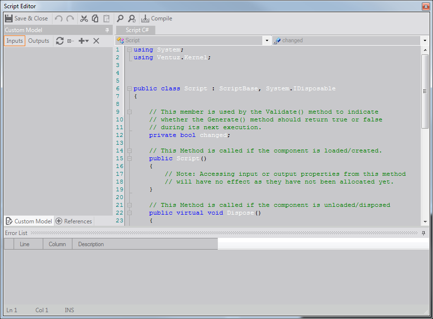

Script Editor
By double-clicking on a script node, the Script Editor is opened. The dock window on the left shows the input and output properties added to this node by the author of the script. By pressing the add button, new properties for float values, strings, methods and so on can be created. The dock window also contains a tab for showing the references to assemblies (i.e. DLLs) that can be used in the script.
The main area of the Script Editor is of course assigned to the source code. The editor offers many comforts of professional IDEs like context highlighting and auto-completion. While changing the code, the Script Editor tries to detect syntax errors on the fly and will list them in the Error List at the bottom of the Script Editor.
The code can also be explicitly compiled by pressing the Compile button in the menu bar at the top of the Script Editor. In order to be able to execute a script, the code has to compile without errors.
The Script Editor usually does a fairly good job of detecting problems. However, there are errors that the syntax highlighter will not be able to detect but the compiler will. Do not assume that just because the syntax highlighter does not detect any errors there are none!
By pressing Save & Close, the changes will be saved, the code compiled and the editor closed.
