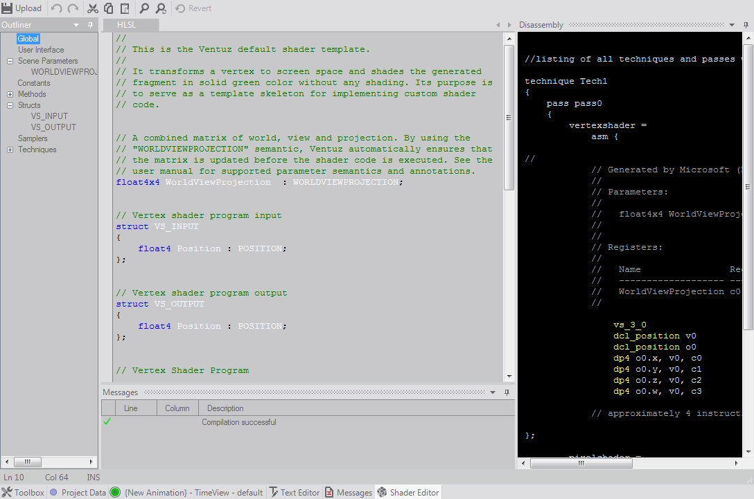

The editor consists of four areas that become visible once an HLSL shader node has been selected:
The Outliner and Disassembly are collapsed by default. To open them, click on the respective label to reveal it and click on the pin icon to keep it so. The arrangement of windows can also be changed by dragging the top bar of each window. However, the layout is not saved as part of a project/show!
Any modification of the shader code is done locally inside the editor without affecting the actual rendering. To save the code to an HLSL node, press the upload button once all errors have been resolved. Only then the results of the modified shader will be visible in the renderer output. Use the Revert button to discard changes and reload the source code from the selected HLSL.
