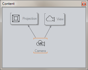

The VR Camera content nodes provides a simple way of generating a view and projection matrix based on common values gathered from camera tracking systems used in virtual studios. A real camera has a position and an orientation in the studio (view matrix) as well optical parameters expressed by the lens, such as zoom, focus and center shift (projection matrix).
The VR Camera has a Manual operation mode where the input properties Position, Direction, View and Center are used to generate these two matrices. These matrices VRView and VRProjection have to be connected to a View Node and a Projection Node to view your virtual scene through that camera. If Manual is disabled the camera data is taken from the connected tracking system, which has to be configured in the Machine Configuration.
