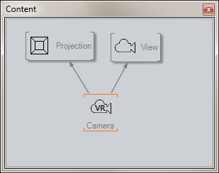

The VR Camera has a Manual operation mode where the input properties Position, Direction, View and Center are used to generate these two matrices. These matrices VRView and VRProjection have to be connected to a View Node and a Projection Node to view your virtual scene through that camera. If Manual is disabled the camera data is taken from the connected tracking system, which has to be configured in the Machine Configuration.
