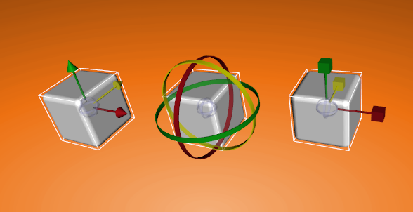

Transformation Gizmos (often called manipulators or widgets) are used by 3D modeling packages to transform objects without having to care about the actual numerical values. Ventuz has three Gizmos (Translate/Rotate/Scale) which can be activated with the respective buttons in the renderer window or by pressing short-cut keys (T, R, S) while the mouse focus is on the renderer window.
Note: The renderer has to be in Editing mode to show the gizmo. You can either switch between normal run and edit mode by pressing Tab while the renderer has the focus or by pressing the respective button in the renderer toolbar. While in editing mode, an orange selection highlight shows which objects are selected. Also note that during editing mode, no mouse input will be sent to the scene.
Each Gizmo has three axes and a center area. By clicking on one of those areas, the gizmo is activated. If one of the axes is clicked on, a mouse move while pressing will cause a translation/rotation/scaling in that axis only. The center area has a different functionality for each Gizmo:
