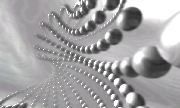

SpreadThe Spread node renders its children multiple times to create the illusion of duplicating objects without the added memory consumption of an explicit copy. Each instance can have a transformation (translation/rotation/scale) that offsets itself from the previous one, creating chain like structures.
