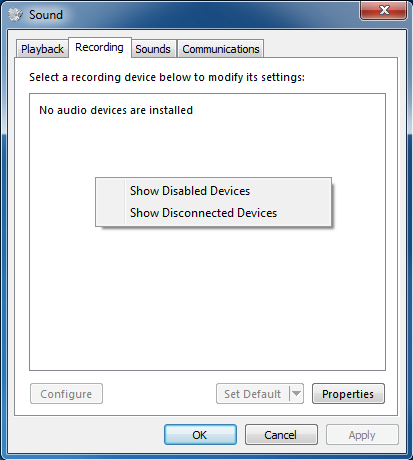

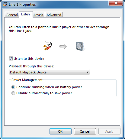

Setup for Sound Capture source
Ventuz analyses any sound source available from the sound card, such as LineIn, Microphone or an internal StereoMix. Under Windows 7 it can be a little bit complicated to set up a sound capture source for the FFT Analysis. Here is a short How-To:
Finally you will have to re-start Ventuz and select this new device in the Ordinal property of the FFT node!
If there is no Stereo Mix or WaveOut device listed, you have to check different driver versions of your audio hardware.
